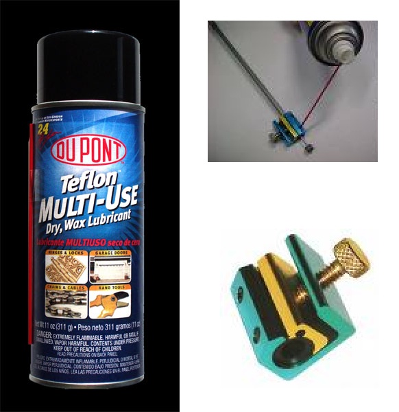

02 May 2016 08:16 - 02 May 2016 08:20ninefourteener wrote: . . . The clutch feels perfectly fine to me. There's nothing "wrong" with it..... but for her, it's hard to reach and stiff.... so I'm trying to figure out a solution to make it easier on her.
Besides the possibility of a differently shaped lever, the previously posted suggestions have for many riders made the lever operation much smoother and far less stiff.
On my KZ900 LTD for example, the clutch lever action had degraded gradually enough to go virtually unnoticed. I had become accustomed and adapted to it, and it still felt okay -- I had forgotten what "perfectly fine" actually felt like. Lubing the cable helped somewhat, but when the old hard grease-encrusted clutch actuator assembly was disassembled, cleaned and freshly lubed, it was like the difference between night and day.
But where everything else is perfect except for a dry cable, simply lubing the dry cable should help.
As known, here's a quick and easy method to thoroughly lube a cable:
For the clutch actuator assembly, would lube with fresh grease -- not a sprayable lubricant.
Last edit: 02 May 2016 08:20 by Patton.
