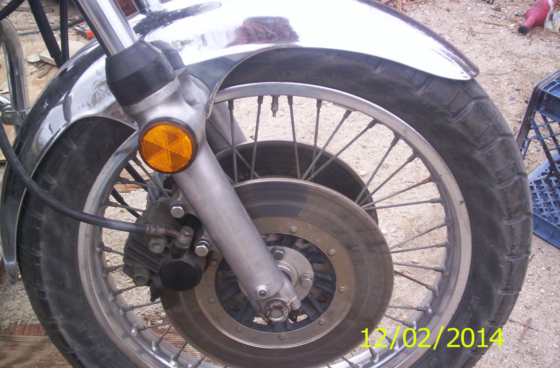

I have duel disks and H2 calipers. I can lock up the front wheel if I want to. Tire selection makes a difference too.
Last edit: 27 Apr 2016 11:57 by SWest. Reason: Add pics
