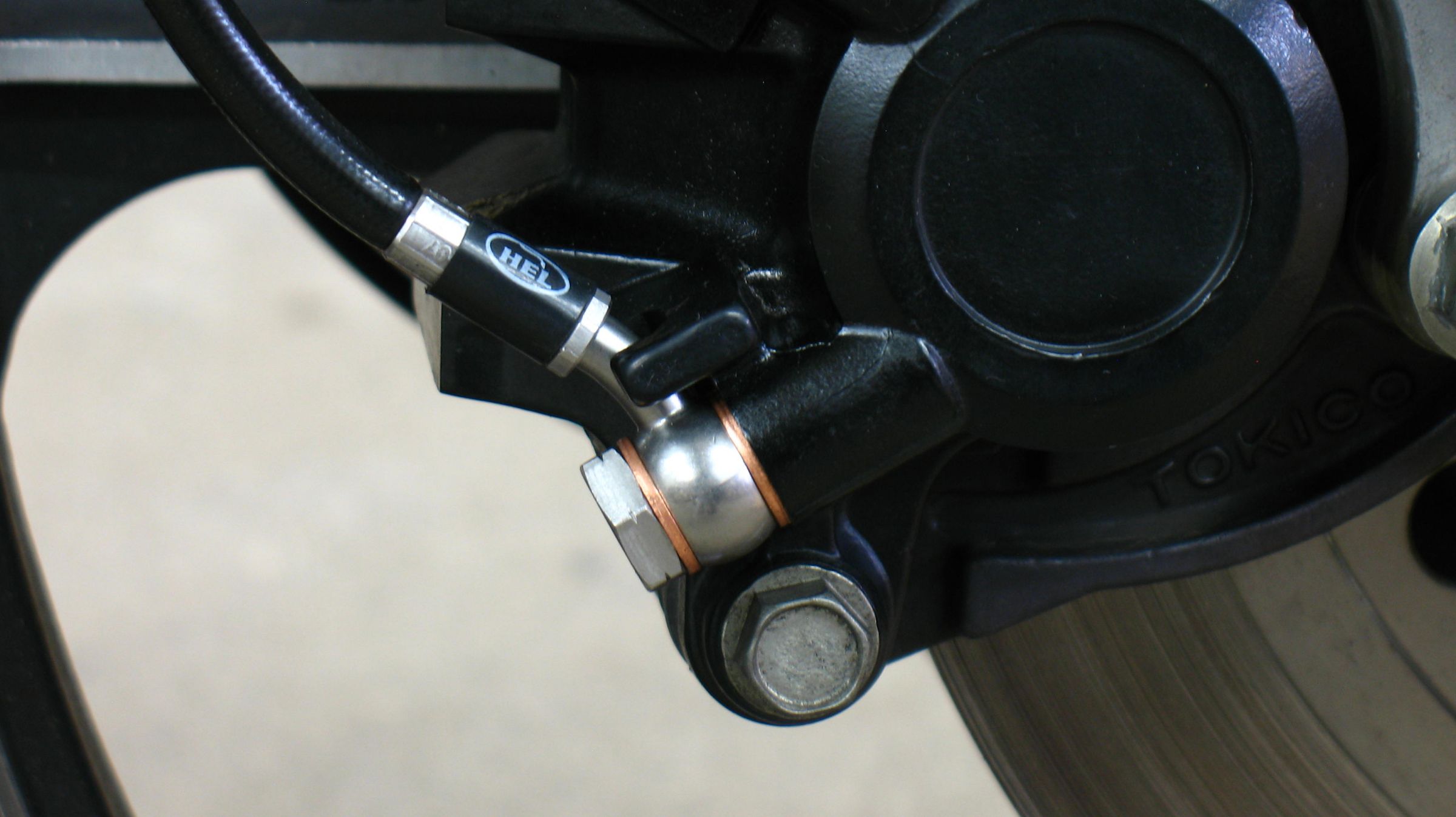

Does this installation look ok?

Re: New (HEL) SS Brake Lines
15 Mar 2016 08:21
#715505
Looks good to me. Just lift up on the handle bars while on the center stand to ensure slack is adjusted for the forks extending fully.
