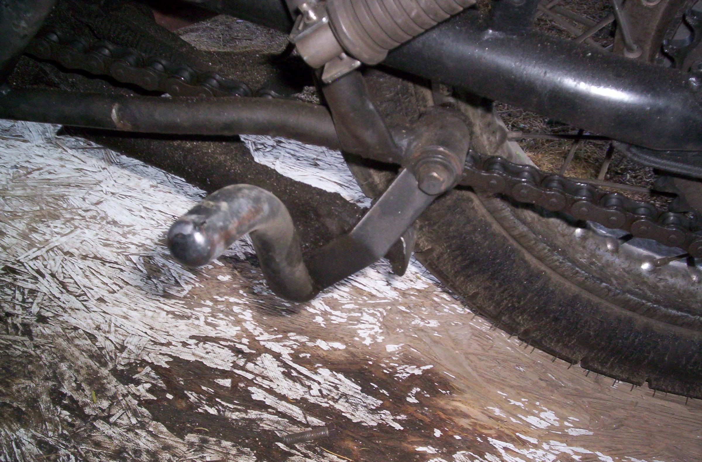

Re: Center stand question
25 Feb 2016 04:12
Not a very good picture but best I could do laying on cold concrete
Basically the bumper (actually a rubber cork) keeps the center stand in the same position and out of my chain. It bolts onto a piece of aluminum angle which in turn is bolted to the old exhaust bracket.

Both of those look good . Thanks guys.
