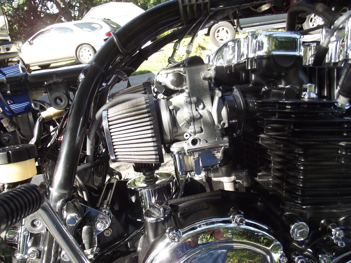

Did you try using the stock cables ?
this is with the stock cables & stock handlebars on my 80 LTD 1000 with the stock 28 mm pumpers
& this is with the stock cables , handlebars, & the RS 34's, just about no more slack, but the cables work fine
Pete
Pete

Yep. but to me that is not good enough, if you dont have enough adjustment its only half fast. what gets me is,everyone that sells the rs 34s didnt have any idea what applications would work you have a 43 1/2 over all lenth with 4" slack cable. what is needed is cable that fits in length and 3 1/2 " slack cable. I have a 44 1/2 over all length just no chrome 90 on the bar end yet. it fits perfect.
