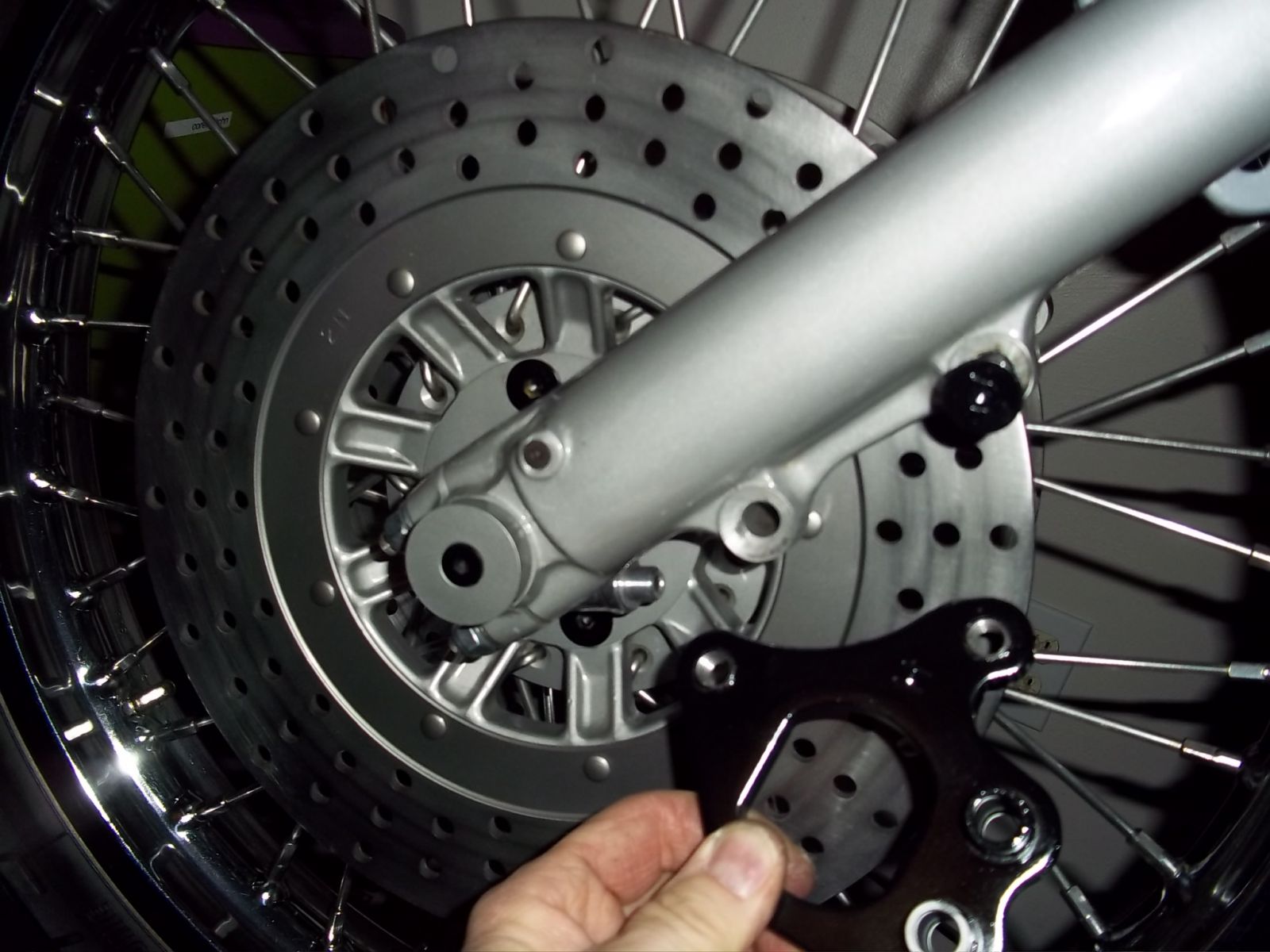

The fine threads are hard to come by. Even harder are flat heads. I used them on my project were ever i could.
Flat head machine bolts, 10mm x 1.25's for the caliper bracket were non existent. Thats why I used 3/8" heli-coils in the picture.
