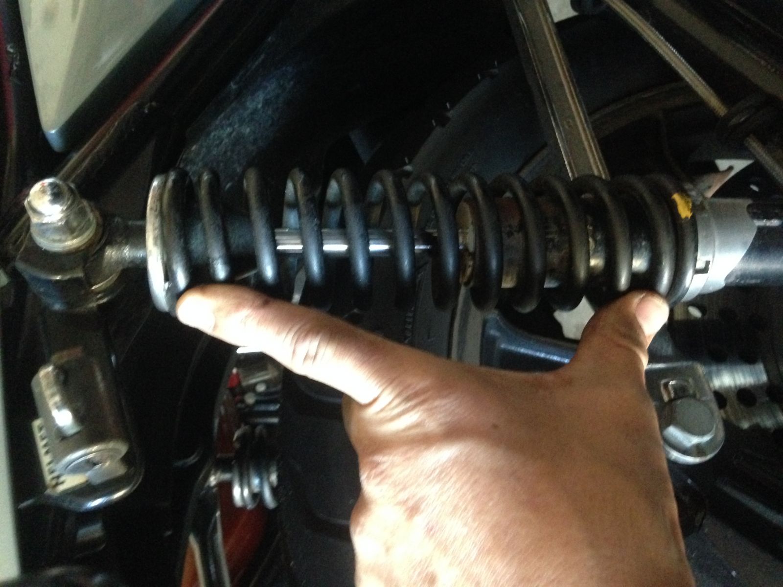

This shock came with the last kz900 I bout. Question I have is ...this there suppose to be a ring between shock body and spring.
Spring move around and if it move to one side it kind of hangs out.

The spring should NOT move from side to side & overhang under the retainer
Pete

Shouldn't there be some kind of deep shoulder washer to keep the spring centered?

That s what's missing ...the retainers washers.
Someone know where I can get 4 of them?

I goofed up on a pair of shocks once , I removed the cheap and nasty looking plastic insert then realised why it was there.

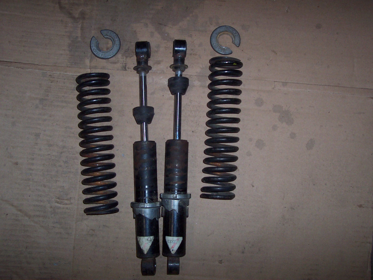

30 Dec 2015 17:36 - 30 Dec 2015 17:37You are not missing any washers I have two sets of koni's, You have a shock, a spring and a top retaining collar.spdygon wrote: That s what's missing ...the retainers washers.
I picked up these koni's today that have been in attic for 20 plus years . there are no retaining washers. If there loose, the springs are probably worn. adjust the tensioner and maybe the spring wont slide around . On the the least setting the spring will be loose
This is a koni shock,nothing more

30 Dec 2015 17:39Tyrell Corp wrote: I goofed up on a pair of shocks once , I removed the cheap and nasty looking plastic insert then realised why it was there.
Please explain about the plastic insert. Why is it there
