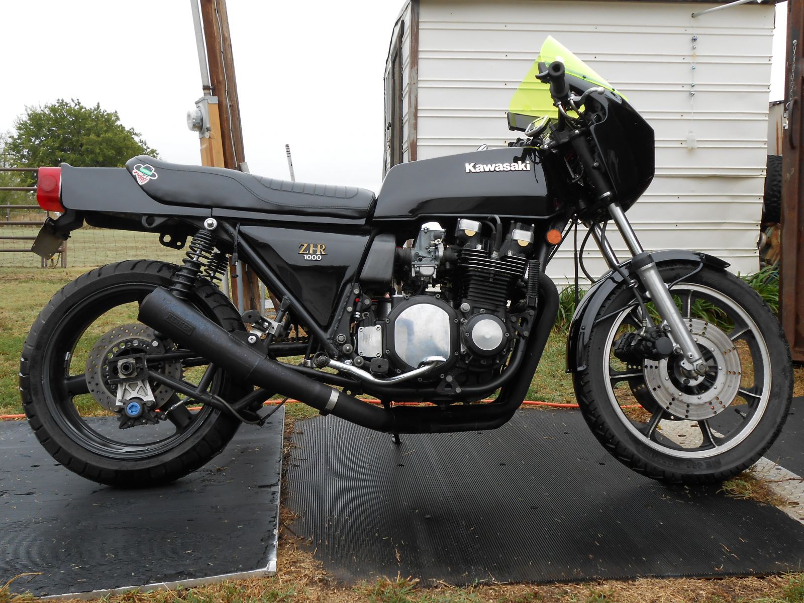

the early 900's had bushings,the later bikes got needle bearings.
sooo,did kawasaki consider it an upgrade??? i don't know...
but no other later kawasaki's returned to bushings,they all have needles or a combination of ball bearing and needles depending on the model.
if you plan on "spirited" riding i would consider a stiffer swingarm to be the first handling upgrade.
as the seamed tubing used in the swingarms is slightly stiffer than a noodle.
and, when pushed hard is the biggest cause of instability imho.
i have 3 78 z1r's and one 80 z1r and have never felt that they didn't stop well enough.
so you may want to get the stock brakes up in working order and decide then if you want to upgrade or not.
here is a pic of my 80 z1r which i custom built a braced chromoly arm to deal with my "spirited"riding.
i have a little too much tire(190mm wide)but i like the look and love the stability of the braced arm and large contact patch.
as you can see i upgrade my rear brake to the blue spot r1 rear brake and can't tell any advantage over the stock rear brake.
p.s. i do plan to convert my front end to a usd and matching r1 front wheel and brakes.
the way it sits now is the best handling kz i have ever ridden,my hope is that it handles and stops at least as good as it does now when i convert the front end.hth
