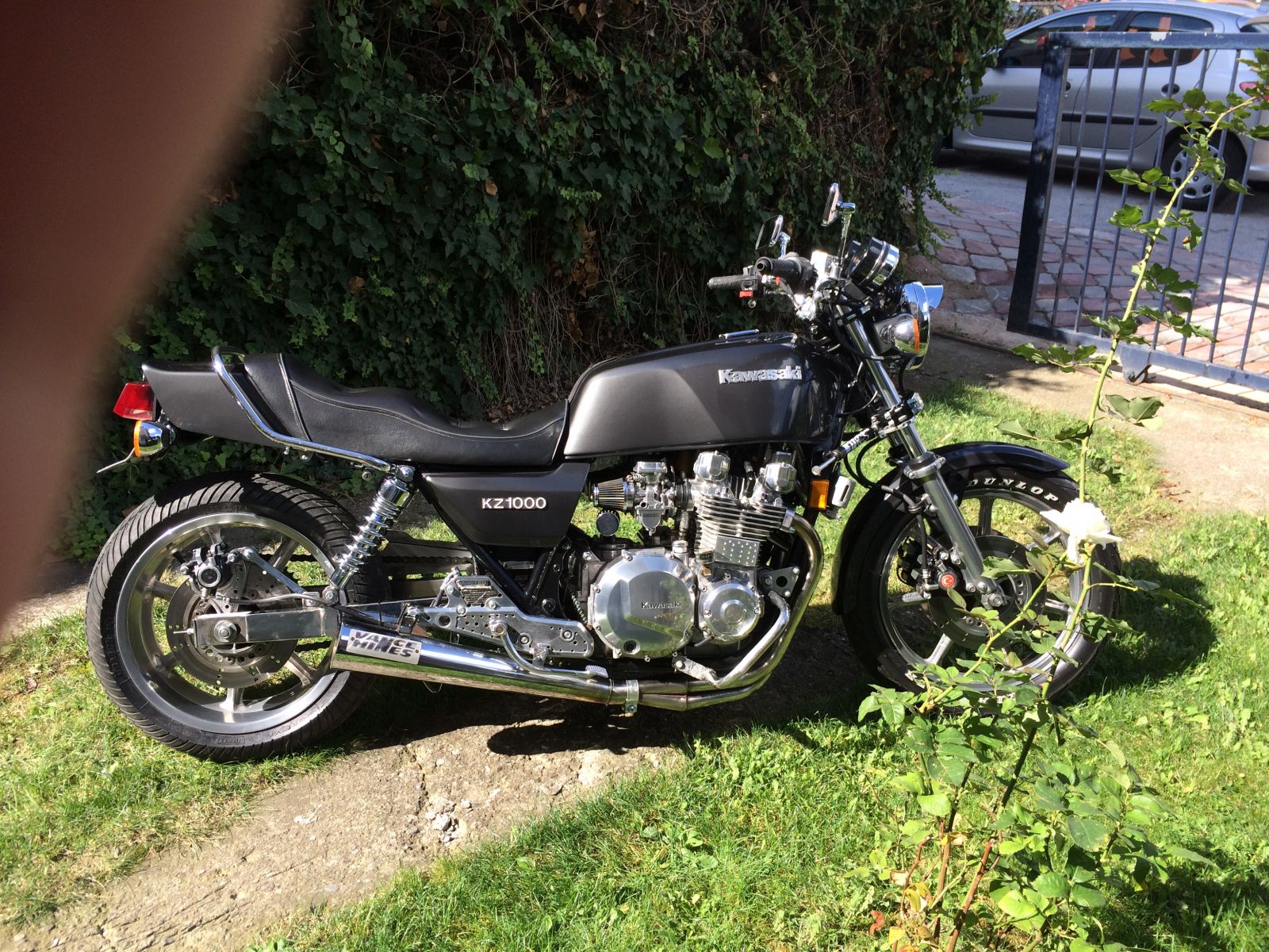

A stock chain used on a stock swing arm will not come in contact with a stock shock. What bike is this on, and what have you already done to modify it? Got pics? Ed

I noticed that. I wonder what else he may have done. Different swing arm or spacing of the wheel or sprockets so the chain wouldn't rub the wheel?

Tell us more about your bike! Is that a big block cylinder or are my eyes deceiving me? Emgo pods?

26 Nov 2015 16:35What is the rear rim? A 17" looks great! I don't see any weld seams, Not a double weld! Fits the cycle great. Looks OEM.
What is your offset? Have to have some? 3/8" 5/8"
