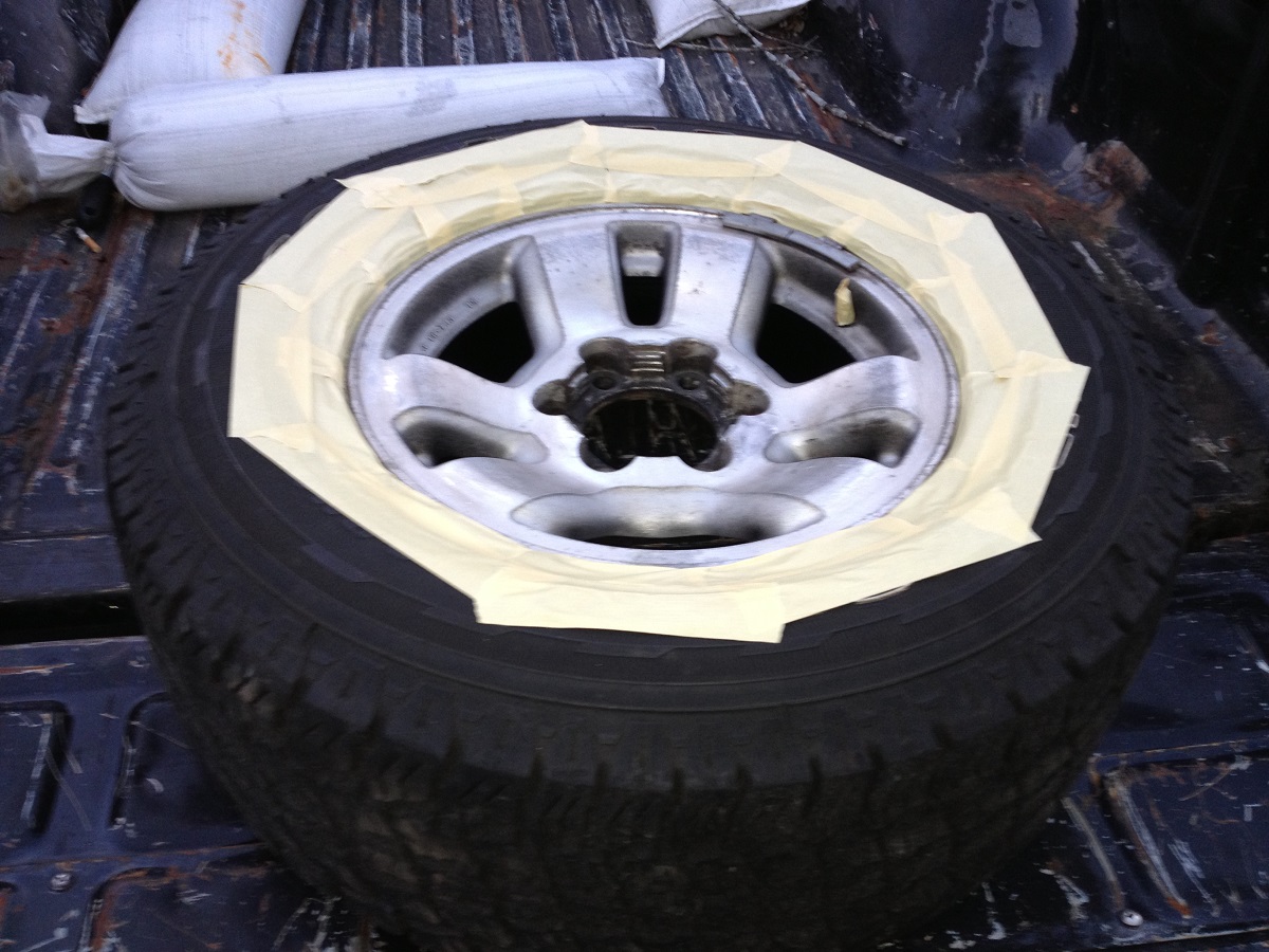

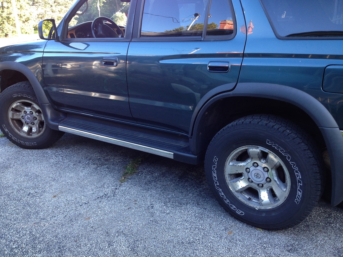

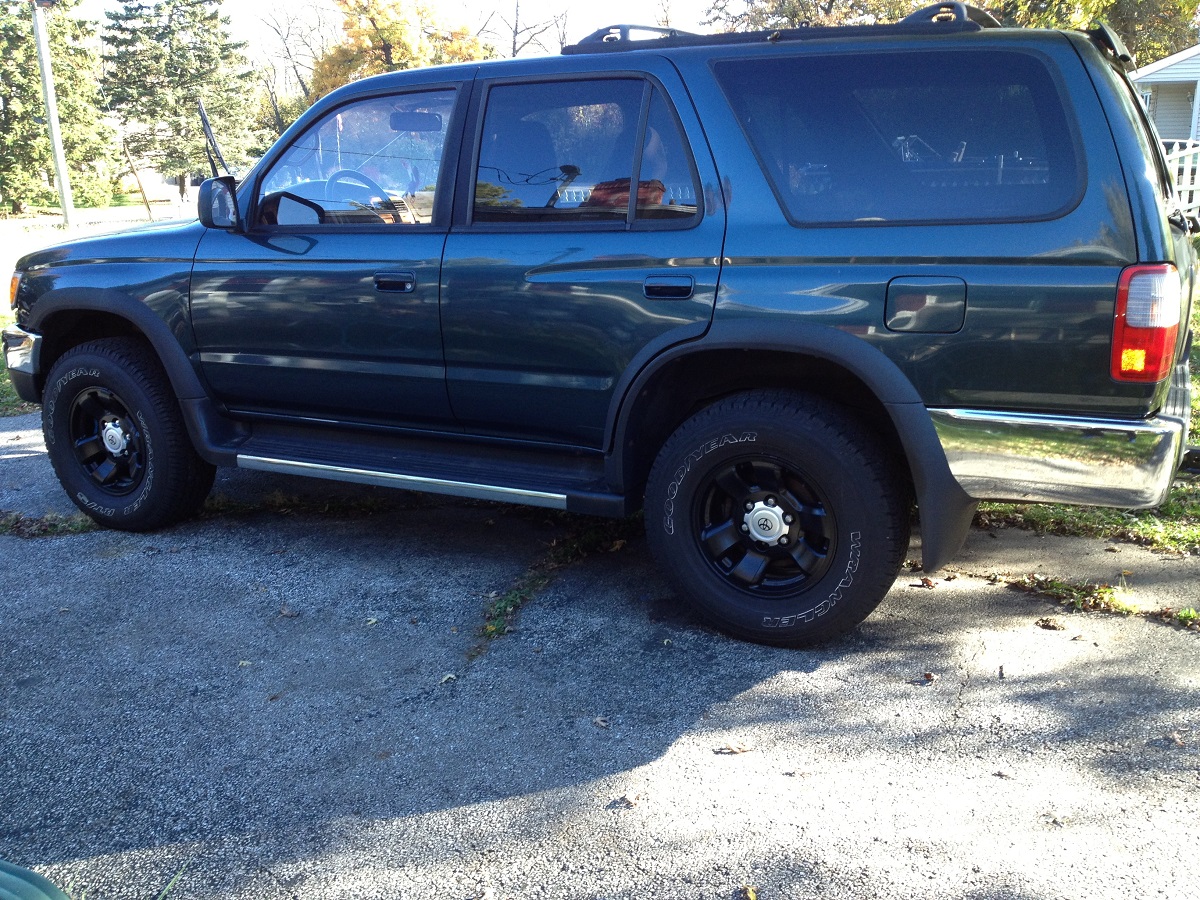

+1, I just painted the wheels of my SUV but I used masking tape cut into 3-4 inch pieces & over lapped them, It's much easier than using long pieces, then used larger pieces of tape to cover up the rest of the tire
how they looked before
& after
The most important thing is the prep work, the rims have to be free of ant loose dust or chemicals, so lots of Simple Green & then followed by Brake Cleaner
there are many You Tube Videos about wheel painting
I used VHT Epoxy Paint, which is self priming, no primer needed

Nice painted rims but that's some nasty scares Senior. :blink:
