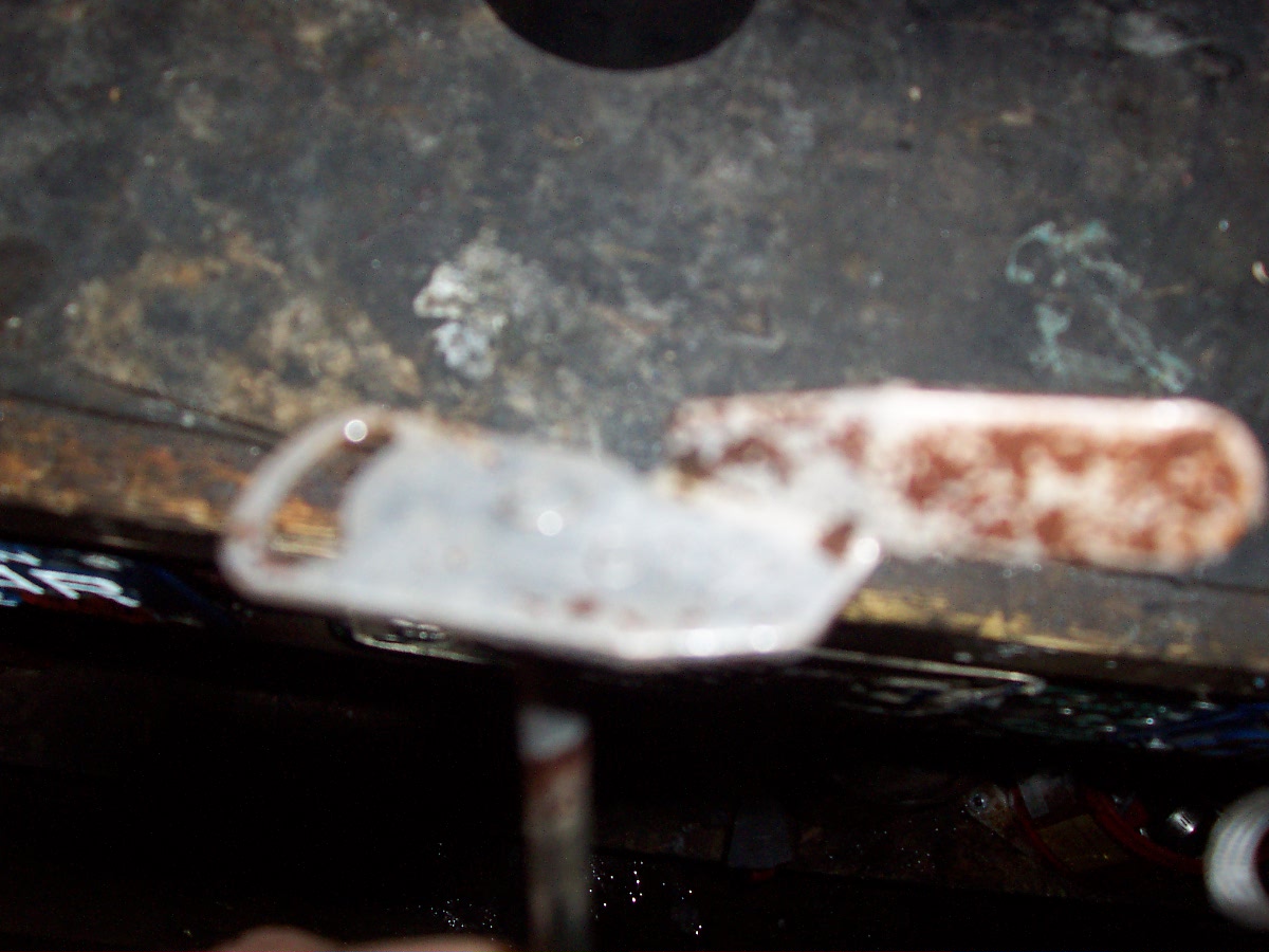

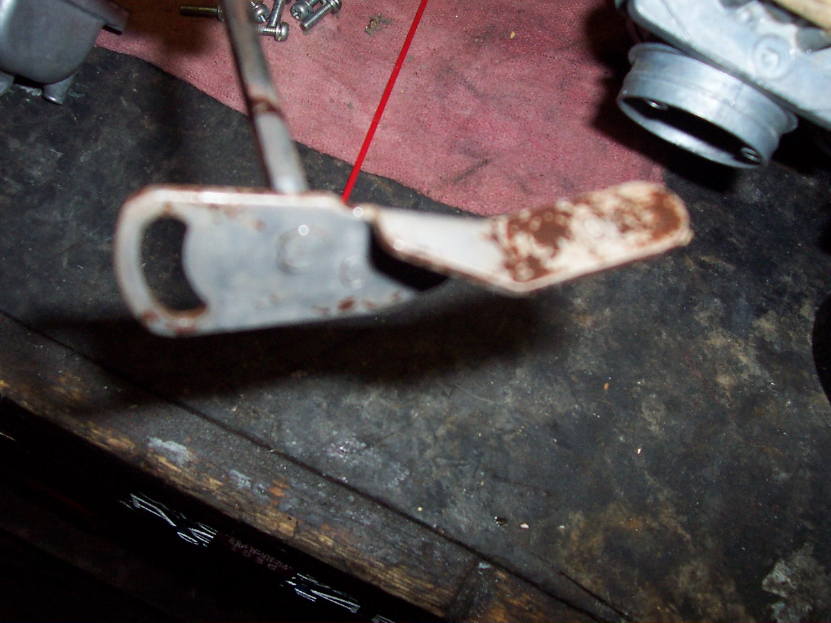

This choke lever was solid rust. I started soaking it this morning. As you can see most is gone, I will let it soak over night and it will look new
I will post another photo tomorrow
