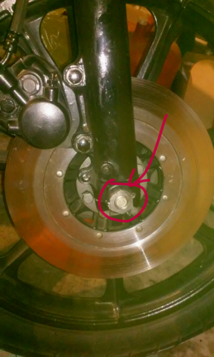

U mean the bolts that hold that thing that goes through the front tire that holds the speedometer drive on?

There are axle holder clamp bolts or nuts & the axle goes thru the speedo drive unit.
He means the bottom allen bolts on the forks.
You have to remove the axle holders first to gain access to the allen bolts --- aka fork cylinder bolts.

22 Oct 2015 13:24martin_csr wrote: There are the axle holder clamp bolts & the axle goes thru the speedo drive unit.
These won't come off. They are regular thread right? Not reverse?

22 Oct 2015 17:11 - 22 Oct 2015 17:12Those are your axle nuts. They are normal right hand thread. They are tightened to a pretty fair amount of torque so take a little effort, and the 2 nuts down on the bottom of the forks when tightened clamp the axle nuts and the big axle nut can't be loosened until the smaller clamp nuts are loosened first. However to do fork seals no reason to loosen the big axle nuts, just remove all 4 bolts on the bottom of the two fork legs, the clamps can be removed and the whole wheel just falls down off the forks. Be sure and get a manual before doing any work or you're most likely going to do more damage than good. Fork seals are not hard on the 650, but there is a procedure, just like any other job.blink543 wrote:martin_csr wrote: There are the axle holder clamp bolts & the axle goes thru the speedo drive unit.
