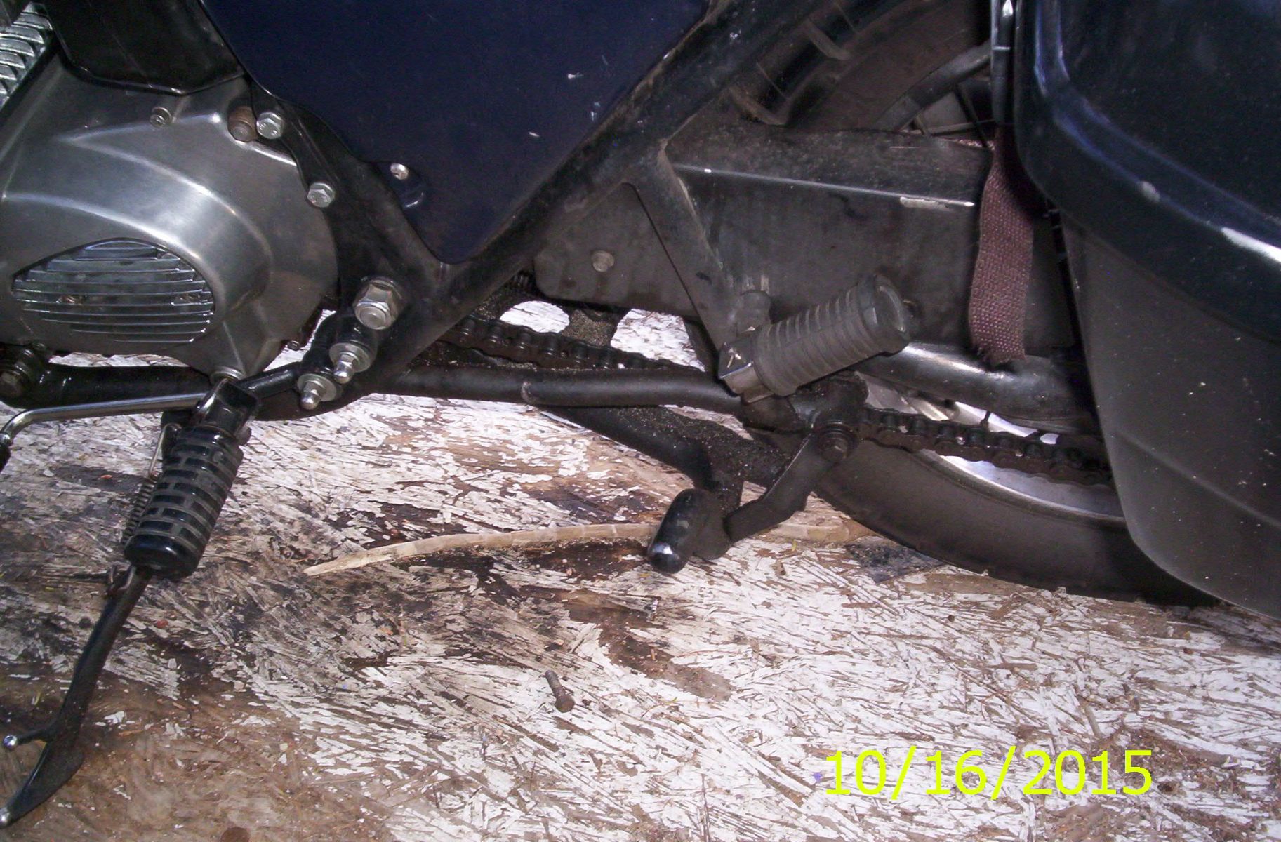

16 Oct 2015 14:11The B4 center stand is designed to have a rubber covered pin butt up against a flat spot on the stock exhaust pipes. Without the stock pipes the center stand does wobble around. I kluged up a way to lash down my center stand using a bungee cord and the two stock exhaust hangers.Stocky wrote: Nearing the end of a lengthy restoration Iim having some issues with the stands.
1. The centre stand has new springs but when it's up it just bounces under the swing arm. Should it be tensioned somehow?
