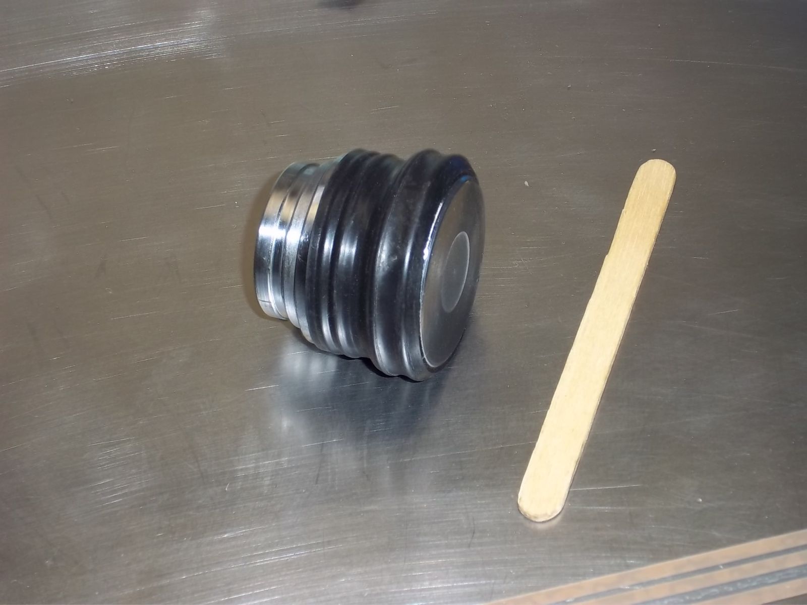

First of all, clean that piston! smooth out all of those marks and gouges. You will tear your new boot.
This is what you do: put the seal on the piston, work it down,(use some brake assembly grease) as to have that lip go around the metal ring. Then work the piston through, while sliding it along the way. use a smooth, small (anything) like this popsicle stick.
As piston pushes into bore, the outer groove will catch the piston. And it's in and done.

You basicly just slide the piston through the dust seal, after you catch it on the metal ring lip.
It might take a few tries.
But when you get it right, it will amaze you how easy it is.

Hey, the metal ring should be in the caliper, always, tight hammered in. And stays there. And the thin part of the boot catches around that metal ring. Slip piston in and work it down, have either brake grease or brake fluid as a lubricant. Te thick 1/8 x 1/8 grove goes in the piston grove at the back, outside of piston. You have to keep the dust seal hooked around that metal ring as your sliding piston in.
Tap that ring in and leave it. maybe your seal is upside down?
Take a break, drink a beer. Try tommorow.
