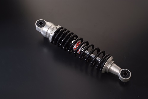

I just fitted a set of these;
Nice quality at a nice price. Havent road tested them yet but when I sit on the bike(on the work bench) and go brmmm brmmm,they feel good.
www.yss.co.th/index.php
