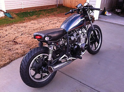

So if I get new tires they have to be the biggest that can fit the bike. As long as it don't rub I'm fine. Please don't tell me to stick with skinny stock size. I need the chunky look. This will be a around the corner and back bike so no long trips anywhere. This is the look I'm going for
