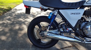

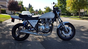

Here are a few pics of my completed swing arm ,wheel and new 180 tire on my Copbike 1000

Looking good. If you don't like the way those shocks ride, Chris Livengood rebuilds them. swaps out a couple of internals puts quality oil in and fills them with nitrogen.

So far so good on shocks but will consider rebuilding em if they act up!
