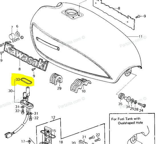

"O" RING,FUEL SWITCH
43058-1004
Seems odd that this part went obsolete. It was used as recently as 2012 on some models.
Any suggestions for a replacement? Found a couple on ebay and the shape is round?
43058-1004
