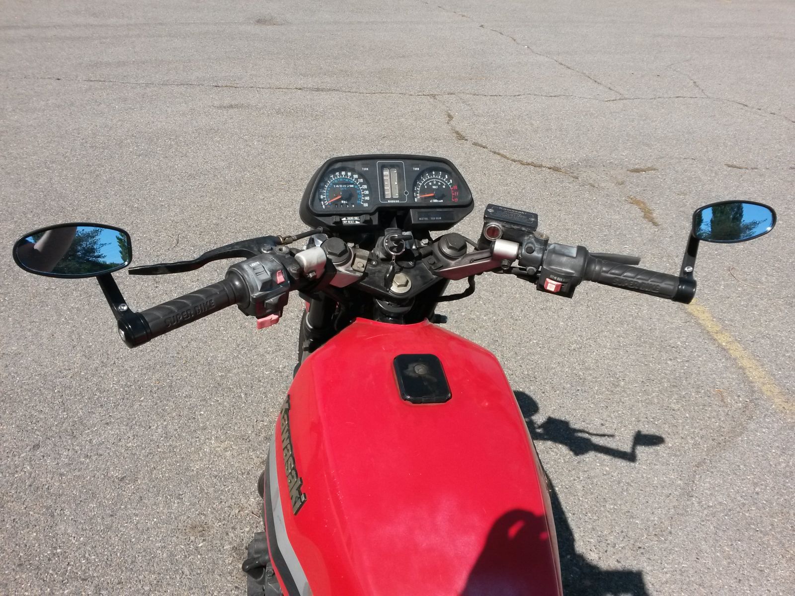

Got them and installed. I like the way they look but I don't like that my throttle is tighter now with the mirror attached. Also, how do I use the throttle side mirror correctly? It will obviously be in a different spot constantly while I ride.

29 Sep 2015 18:13You need to either back it out a tiny bit and/ or trim more off the grip. I had the same issue when I first fit them. I took the entire flared ends off the grips to make sure they were fully inserted into the bars without interference.Shabba wrote: Got them and installed. I like the way they look but I don't like that my throttle is tighter now with the mirror attached. Also, how do I use the throttle side mirror correctly? It will obviously be in a different spot constantly while I ride.

nice willys! :woohoo:
