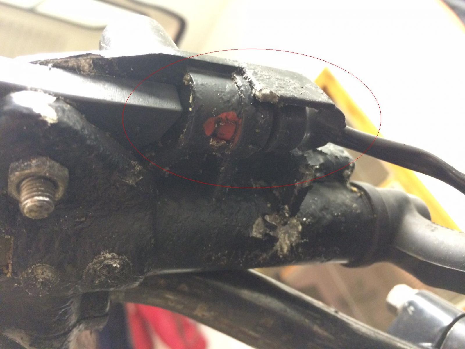

Hey guys,
Awakening the 81 GPZ from a 11 year slumber. I am rebuilding all calipers & master cylinders. I cannot figure out how to disconnect the brake light switch from it's wire at the front brake lever. The robber boot that covers it kept the connector clean & intact. It looks like I should be able to push in the little tooth that engages the socket on the switch. (making the assumption the thing can come apart and that is the right way to go.)
Getting frustrated. Only one pair of hands and this thing is kind of recessed into the lever assy so I cannot very well hold it and try to disconnect. REALLY dont want to spill brake fluid on the new paint. Or break it. Is there a better way? Special tool? Disconnect plug elsewhere in the harness?
TIA,
Bill

Hi, use a thin screwdriver to push the tabs in and it will come out. Put some photos up of the bike when you get time, the 81 is one of my favourite bikess

Push in the red tab, pull out the switch.
The red paint around the square hole must be a factory thing, because my 81 650 has a little red paint there as well.
