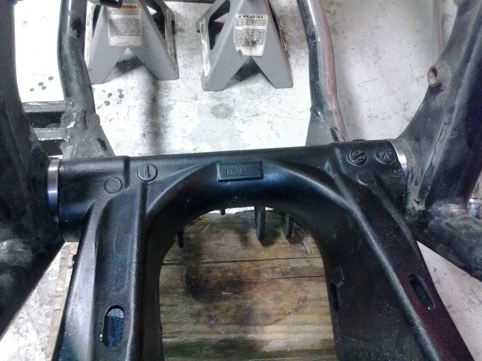

many thanks for that Davido!! I have literally just got back from purchasing a complete rear end, swingarm with wheel which was still in situe and had the caliper which was still bled and the footrest with hanger all still attached. I also got the rear shock just incase I go mono and a set of 6 pot front calipers - very much a bargain.
Looks like I'm going to have to mill away around 14mm off the swingarm at the pivot and have some reducers made up to take the narrower KZ pivot bolt, bearings shouldn't be too much of an issue?
Pic attched of the 750 so far.

well I finally got some measurements from the ZX7R swingarm and it's 20mm wider than it needs to be to fit inbetween the standard 750E bosses in the frame.
It is possible to machine away some of the material from the swingarm but I fear it will be too much?

You might be able to take a bit off the swingarm and a bit off the inside of the frame. Dont know how safe that would be though.
Another thing to watch out for, is, even if you get it fitting ,look out for clearence between the swingarm(right behind the pivot tube) and the frame downtubes ( around where the passenger footrest brackets are). The arm needs room to move up and down with the travel of the shock.
I had to whack my footrest brackets off and things are still a bit tight. Im waiting for the shocks (ordered a few days ago) to measure the travel and see if I have to grind a bit off the sides of the swingarm. I hope not!
For the rest , your build is looking good. Nice clean welding.
P.S. Might be wrong but looking at the measurement on the second photo,You should be measuring twixt the inside of the round sticky out bits. Not the frame tube. You could be looking at more than 20mm difference.
An,uther thought. I remember a thread recently when someone cut the cross brace (under the swingarm pivot),forced the frame open with a car jack and rewelded it.

cheers Davido just sent you a pm...I posted the wrong pic with regards to the measurements of the frame...hold brb :whistle:
ahhh that's better
ahhh that's better

Pic of the swingarm in the frame at present.

That frame will turn into a pretzel before that swing arm bends. :lol: I was thinking jack up the swing arm and put a 1100 on it. :woohoo:

Re: All in one ...
18 Jun 2015 21:17
:laugh: :laugh: :laugh: :laugh: Steve if it turns into a pretzel I'm eating it .... I love a good pretzel :woohoo:
