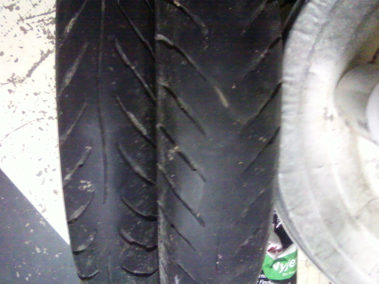

I do my own mounting and have found some of the metric tires hard or impossible ( for me) to mount correctly on old KZ rims
OLD
NEW
I bought a set of Avons aprox. 12,000 miles ago and after I got them scrubbed in ( it took a while ) they work well,
so I bought another set.
OLD
NEW
