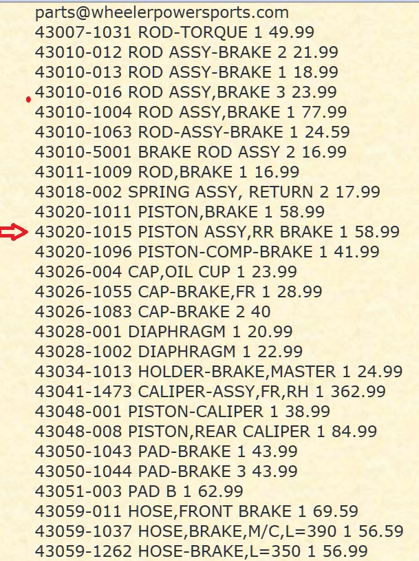

43020-1015 rear m/c piston
www.cycle-parts.com/ShoppingCart.aspx
Allows "adding to cart."
wehaveyourmotorcycle.blogspot.com/search?q=43020-1015
Claims to have the piston.
For these two suppliers, would call ahead to verify actual availability before sending any money.
We know from experience how some suppliers list everything and then later report NLA.
