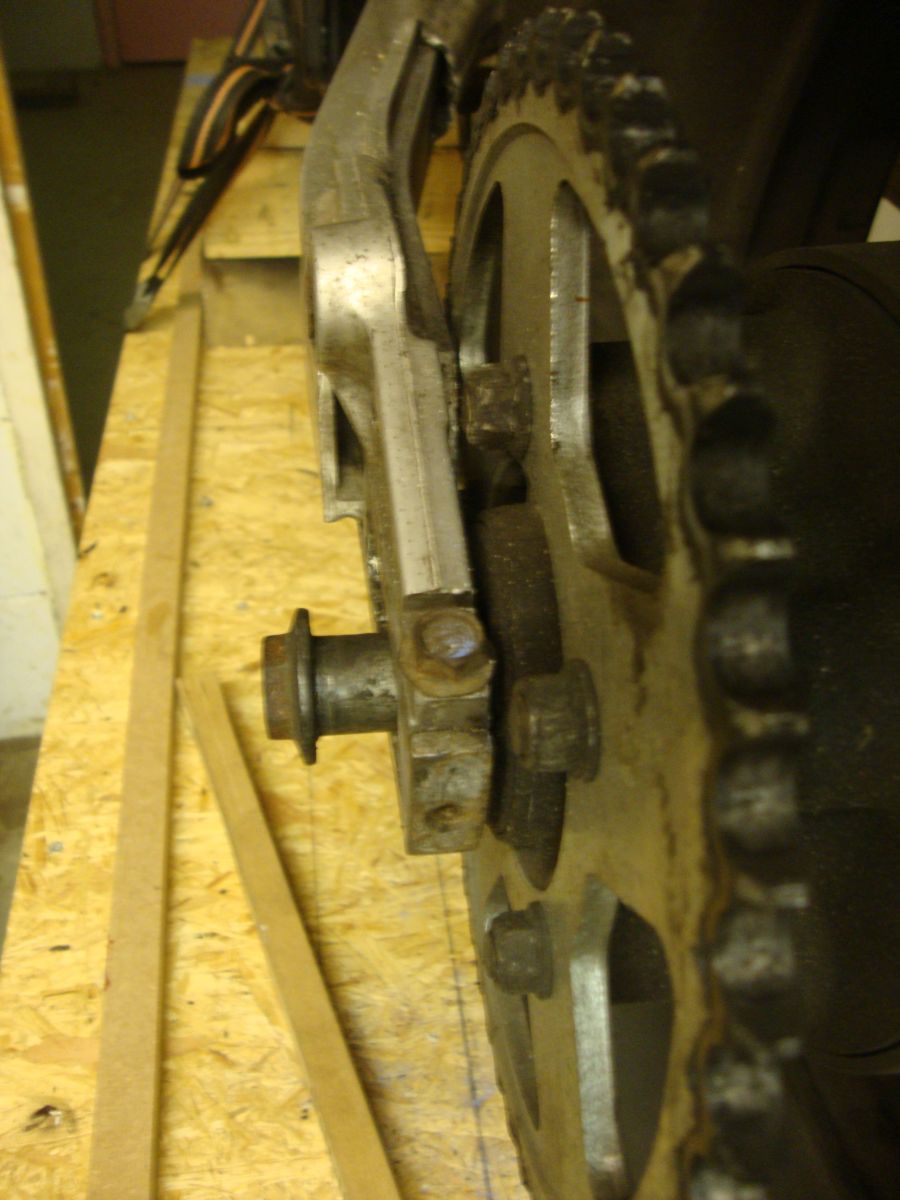

- Espen
- Rider and builder
- Posts: 9
Re: 1982 Kawasaki GPz750-R1 Wheel swap.
20 Mar 2015 22:35
with the man?
the Front is an easier job because its basically just about finding new tapered bearings for the triple tree.
(AllBallsRacing.com is great for finding the bearings.)
the 07´ GSXR-750 fork was complete with brakes,discs and clip-ons,levers etc.
got the front wheel from an 09´ gsxr600
it was basically just a swap.
when It comes to the rear, I have to match the axle,chain alignment and width of the wheel to the original wheel, and thats the tricky part, finding a 3 spoke cast rim that matches.
Again, the Norwegian laws sucks hehe, so its best to make it look as non-modified as possible to not stand out at a control etc.
(it costs quite a bit, and can be a real hassle to get through the MOT and licensing)
so until i find a match, Ill just keep it stock at the rear end.
