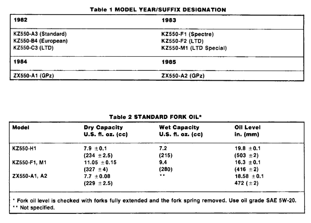

Does anyone hold a service manual for a kz550-f1 spectre 1983 and would be William to share the specified fork Oil capacity ilt level?

See following links courtesy of KZr Member loudhvx ---
General
home.comcast.net/~loudgpz/GPZweb/index.html#home
Service manuals
home.comcast.net/~loudgpz/GPZweb/Mnls/Mnls.html
Here's an example of information that includes the 1983 kz550-f1 spectre, which is found in:
home.comcast.net/~loudgpz/GPZweb/Mnls/Kz...9to85_ThirdParty.pdf .

It seems messy always having to remove the springs in order to measure for the correct oil level in the forks.
Once the level is known correct, and springs have been replaced inside the forks, could fashion a dipstick (perhaps with a wood dowel) and mark the level with the springs inside the forks.
Keep the dipstick as a "special" tool for next time, then being able to check/replenish/flush/fill without having to remove the springs to determine the proper level.
I don't know why some models have fork oil levels measured with springs removed, and other models have fork oil levels measured with springs left inside the forks.
Perhaps having to remove the springs encourages measurement of the fork spring free length to assure being within service limits.
