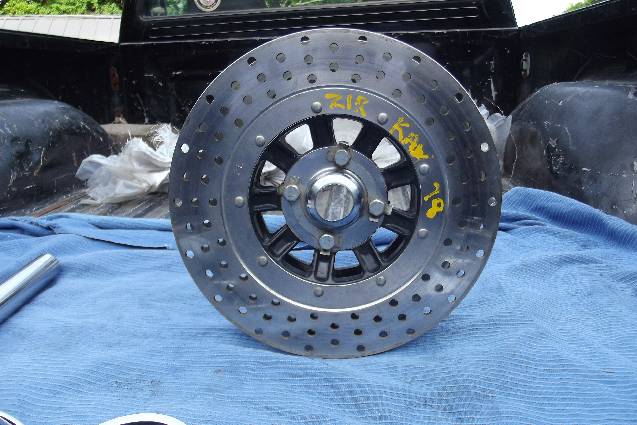

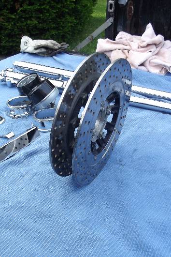

14 Jan 2015 11:22
#658676
Mac, you don't mention what year / model bike they are going to be used on, you may be able to get some Factory drilled discs from another year / model bike , that will work & be safer than taking away the integrity of your sold discs
I replaced my stock discs with factory 78 Z1R discs on my 80 LTD 1000
stock discs
Attachment HPIM5166-Copy.jpg not found
Z1R discs
Pete

#658712
As far as I can tell, the Z1R disks and the disks on the LTDs are exactly the same, except they have different hole patterns. I have often wondered if anyone has shadily gone into business buying blank disks off of KZ1000s and KZ650s, drilling them in the Z1R hole pattern, and then selling them on Ebay as the genuine article. Z1R stuff pulls crazy money on there, when often the same parts can be found on other models.
