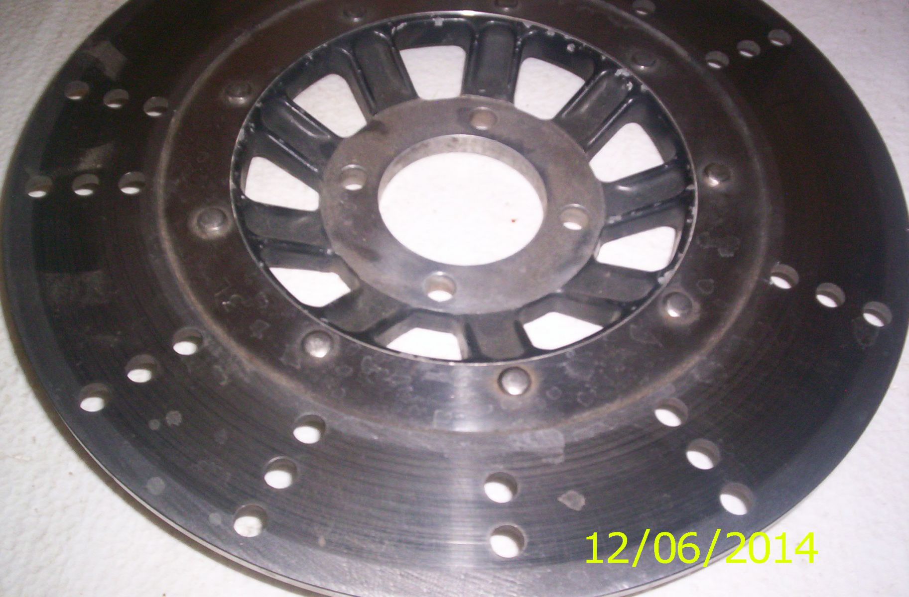

Here's a early KZ disk. They were on LTD,KZ and KZP's. I never understood the odd spacing. Once I wave them turned, they'll be on my bike.

06 Dec 2014 18:58swest wrote: I never understood the odd spacing.
I also noted the weird drill pattern, on many of the stock disks, a few decades back. I wonder if it's not a weight balance thing? ...but no way to confirm or deny.

06 Dec 2014 20:12swest wrote: I never understood the odd spacing.
I have a theory that it's to reduce the noise from the pads running over the drill holes. The Z1R rotors make very a noticeable "fizzzzzzzzz" sound when braking.
I was thinking that an irregular spacing between holes would spread the sound frequencies around and make the noise less noticeable. They do this with blower fan blades to make them less annoying, by making each blade a slightly different size and shape. The idea is that the overall sound level may be the same, but the noise is spread out over a range of frequencies instead of one single frequency, so it's less annoying. More like white noise as opposed to a single tone.
I have no idea if this is why Kawasaki used the odd spacing... it's just my crazy idea.

06 Dec 2014 21:01!Seymore wrote:swest wrote: I never understood the odd spacing.
I've had them on twice. I thought about balance so I tried to off set them. The way they're drilled, it is impossible to get them 180% apart. It might have to do with harmonics. Maybe someone can find out.

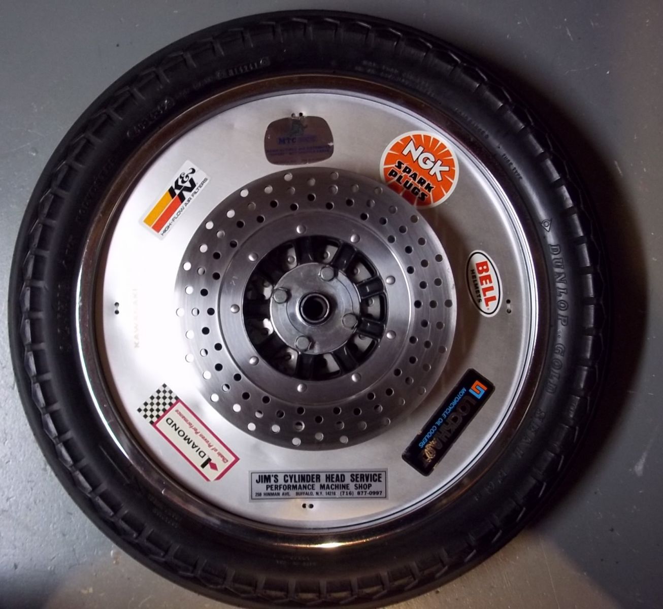

07 Dec 2014 16:29 - 07 Dec 2014 16:57Attachment Z1KZH2conversion.jpg not found
I dropped by a friends today and brought my disks. He has a machine shop in his garage. I showed them to him so he put one on the lathe and checked it out. Seems the disks have high spots sure but the problem was the hubs. They were out .004-.010 due to some type of shock. It's funny I didn't notice it when I put a clamp on a fork to measure the run out but there it was. He turned them and I installed them. The high spots are nearly non existent. I'll try some emery cloth on a block to see if I can smooth them out while spinning the rim. As it is now, I can hardly feel anything on my lever. We'll see.
Last edit: 07 Dec 2014 16:57 by SWest. Reason: add pics
