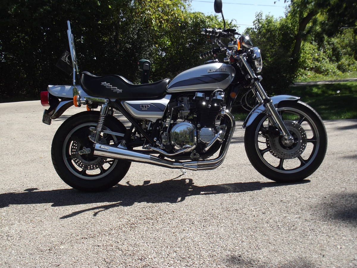

I changed my stock LTD rotors, to 78 Z1R rotors, more holes, lighter, better stopping

That's a lotta holes there Pete :ohmy:

I guess I'm getting more religious ....more HOLY !! :laugh: :laugh:
