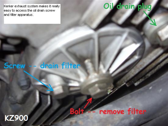

On some of the large fours, it's possible to first remove or fully loosen the bolt, which allows shifting and manipulating the filter cover out and past the pipe.
After the usual crankcase draining, and before loosening the filter bolt, would also drain the filter (if there's a separate filter drain plug), so as to create less of a mess when loosening the filter cover bolt.
Appears to be a stock exhaust system, which would presumably allow for changing the filer without having to remove any part of the exhaust system.
EDIT -- Looks like no separate filter drain plug as on the large fours:
