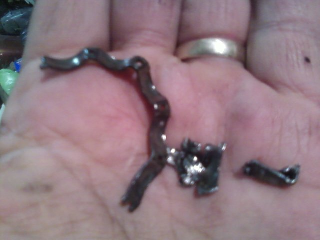

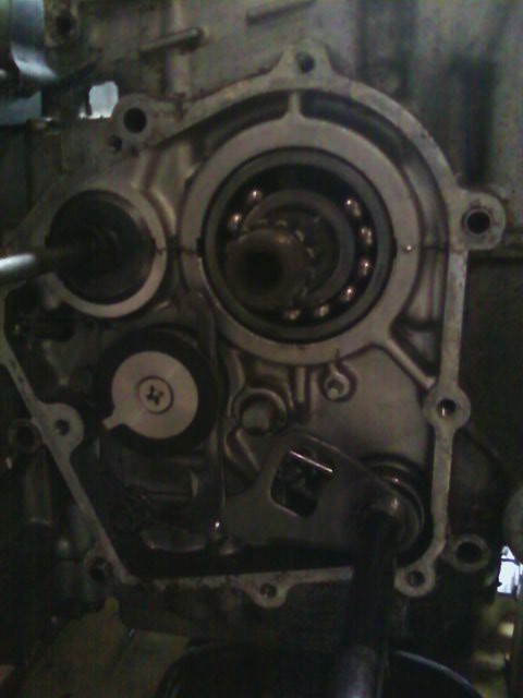

Spend the money on a fresh 530 set up , those tight spots can really screw you up.
I can't prove it but I suspect that running my old chain even after soaking it in white gas for a year , helped mess up the output shaft bearings
I really like my 530 setup , it got rid of a lot of vibration and still looks great after 18,000 with very little stretching .
Just my opinion .
