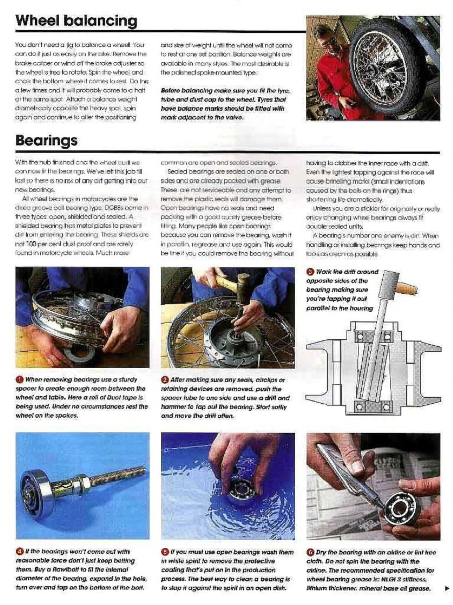

05 Oct 2014 12:00

Jim, where can I get this article from ? I "m having a hard time reading it, even with My glasses on.....It SUCKS getting old

Pete, I found that somewhere online, where I can't remember.
Below are a couple enlarged copies, 125% and 150%, if they copy.
Hope they help,
Jim
Edit: Pete, looks like they are coming out then same size. Check your PM.
Hope they help,
Jim

Jack, the following should be the generic reference numbers for the bearings,
Model-year,
KZ 1000 A1-2 77-78 Front wheel, 6203-2RS Rear wheel, 6304-2RS sprocket hub, 6206-2RS
all bearings listed are industry standard bearings and the numbers should be
recognized by any bearing/hardware shop.
• • unless otherwise stated each wheel takes two bearings and the sprocket hub takes
one.
Hope it helps,
Jim
