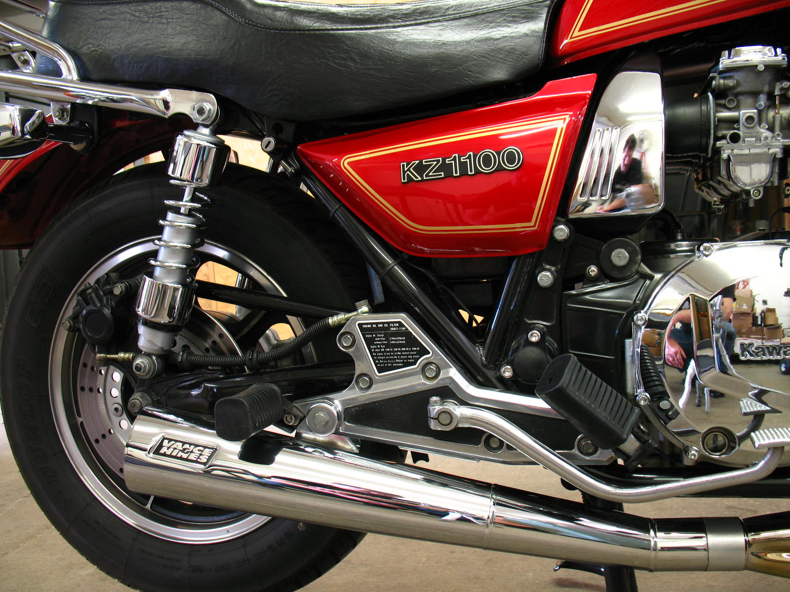

vulcanizer wrote: I want to lower my 78 kz 1000, what shocks can i use? who has used what.
On my 82, 1100, I abandoned the 13.5" air-ride shocks for Progressive 1201 (which are 12.5"), with 03-1368 springs. The silver 1201's (shown below), now paired with 03-1367 black springs with black top covers, are sitting in a box, and I've been thinking of selling them.
www.progressivesuspension.com/pdfs/7100-105.pdf
