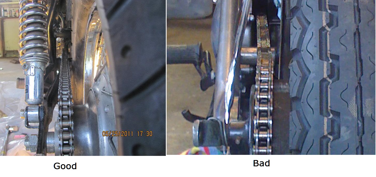

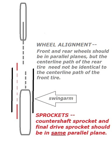

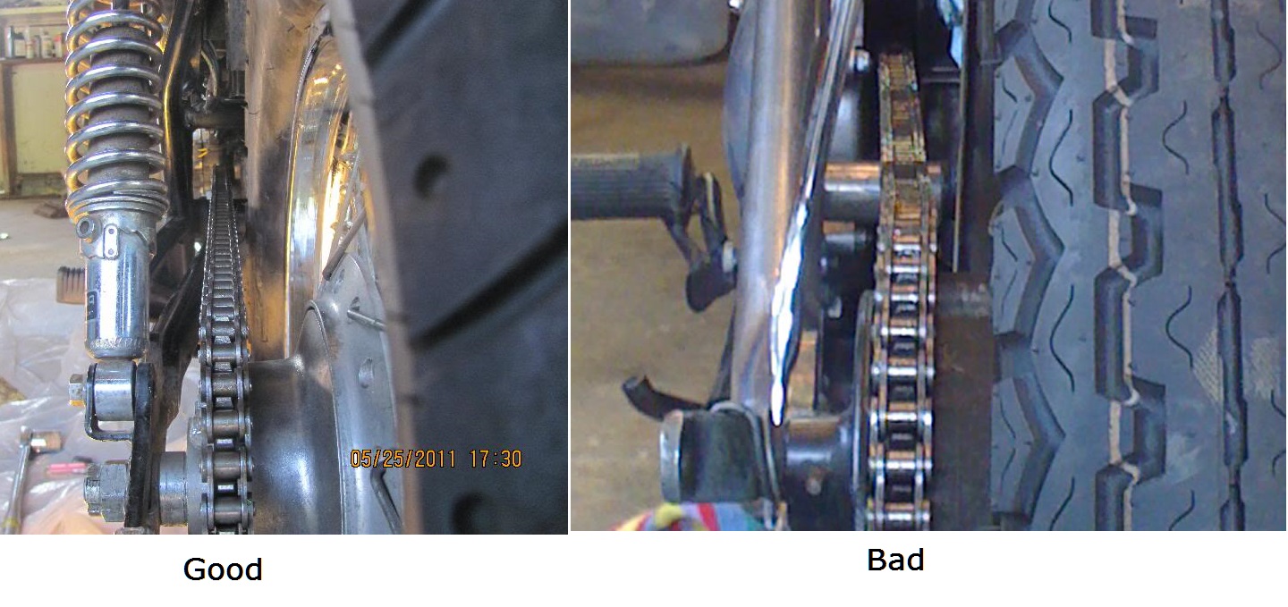

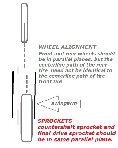

do you know what the offset was specifically? I can run mine with a flat sprocket and know in just a few minutes whether I need an offset or not. Sprocket wear will also help me determine front sprocket offset. Thanks

However achieved, it's critical that the sprockets be perfectly aligned.

okay cool. I got the 305 wheel to line right up with everything with the stock hardware (brake actuator, and torsion bar) and it all bolts up with the factory parts. Now I'm just looking for a front sprocket but I'm not sure about the offset, I need to get the belt guard off first to see. I have a laser so i plan on using that to check the alignment with the front sprocket

I ended up getting a beater sprocket or two from my local cycle recycle shop. The sprocket fits on the shaft and you almost have to tap it on with a rubber mallet to get it to work. Other than that it works out perfectly, with a laser, the sprockets line up very well and then chain clears everything in the case so no worries there. I didn't get time to shorten a chain before I came back to school this week but thats why they make weekends. Hopefully this weekend I will be able to get her lined up and back together for a quick test and tune ride.
