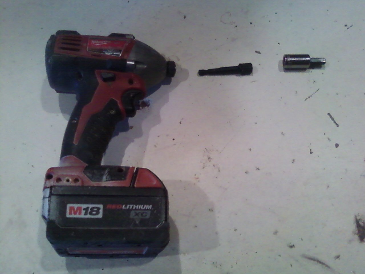

Try using an impact wrench & hardened 8mm allen socket to removed the bottom allen bolts.
(forks assembled & under spring pressure).

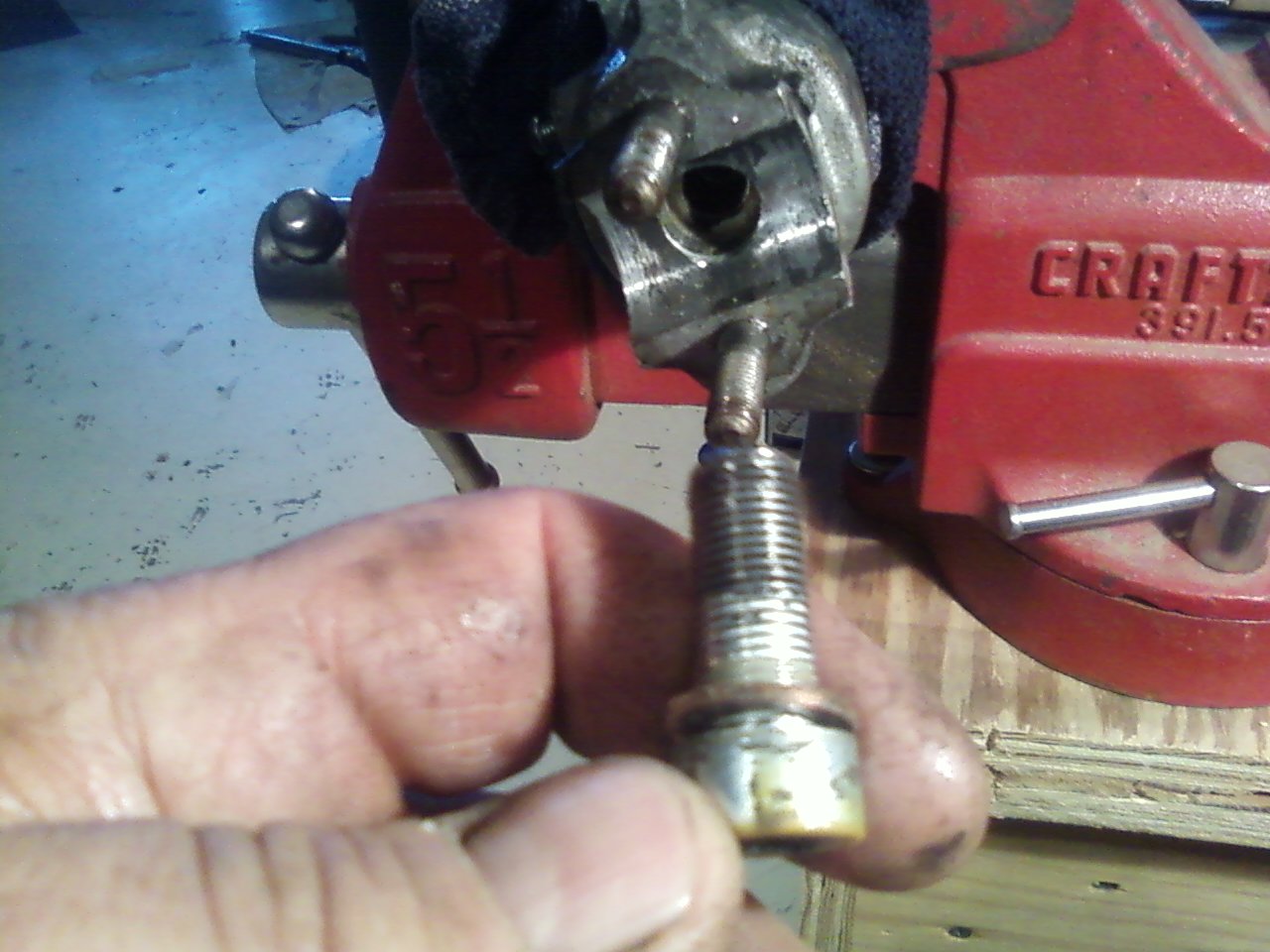

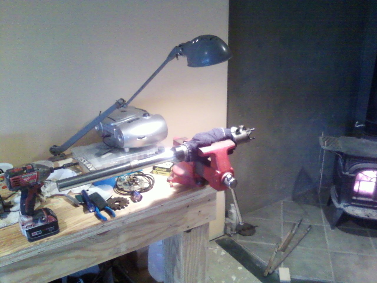

Like Ed and Martin said ," try a 8 mm Allen with the impact tool",
I've done it twice and both times I left the cap on and spring in and compressed the tubes to add more pressure, it helps keep the inner cylinder from spinning.
Don't forget to drain the oil first
