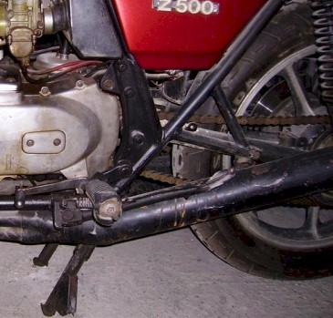

Hi!
I have a 1982 Z500b and im trying to find rearsets for it. Anyone know of any?
I asked fastfromthepast.com since they have for the 1981 model, but they have no info on an 1982 model
And btw it says its a 1983 model, but the seller said that there is no 83 models. True?

Mcdriod is right. Its an euro version with chain drive.
Finding it hard to believe that the 81 rearsets wont fit!

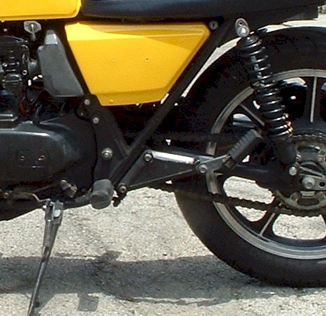

Generally, the standard frames with twin shocks fall into two categories. Those with removable passenger peg mounts, and those with fixed mounts. (This does not include the LTD frames, just the standard frames.)
The earlier frames used tubular sections welded to the frame to form a triangle for rear peg mounts.
The later frames used a cast aluminum triangle bolted to the frame.
I'm not sure what years had which type, but I think that is what will make the difference on the rear-sets, if any.
Raask had rearsets for the 1981 Gpz550, which had dual shocks and the aluminum rear peg mounts. So those might work on your bike if it has the aluminum rear peg mounts.
