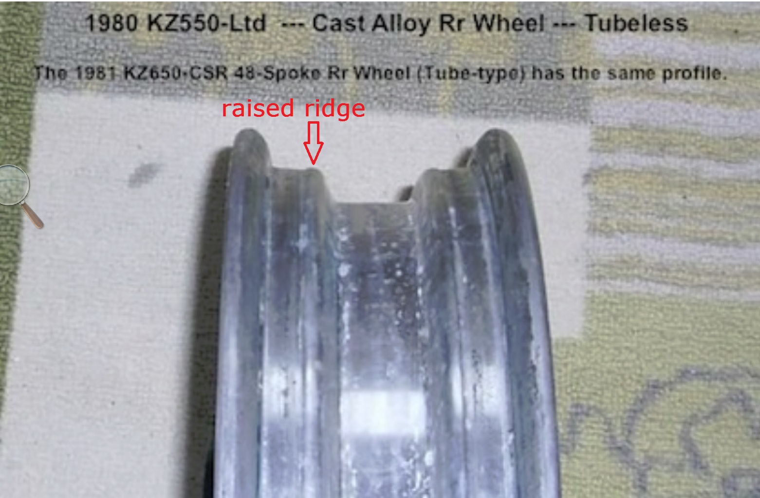

According to Kawasaki.com the 1983 KZ650-H3 (CSR) had cast wheels that did not require tubes (see image below - notice tubes are not shown). If yours are the original wheels I believe they should have the word "TUBELESS" cast into them someplace. However, unless you are familiar with the total history of the bike, don't assume they are tubeless unless so marked because they could have been swapped from another bike with tube type wheels that look identical.
One other indicator of whether or not a wheel is a tubeless type is the fact that the tubeless wheels normally have a ridge that runs around the inner surface of the wheel near where the bead of the tire sits to prevent the tire from being bumped inward toward the center of the rim which would cause it to immediately go flat. Take a look at the second image below.
If your rims are the type that require tubes you can run tubeless tires, BUT NOT WITHOUT TUBES. You absolutely MUST use tubes or the bike will be unsafe.
The really good news is that it is perfectly safe and normal to run tubes in tubeless tires, so don't even try to find "tube type" tires. Tire that are marked tubeless are what we all use along with tubes except when the wheels have the word TUBELESS cast into them. Ed

The front wheel from my 750E2 is imprinted Tubeless, but doesn't have those ridges. Likewise, I have a Suzuki GS front wheel that's the same way. Apparently Kawasaki and Suzuki did not think the ridges are critical. The main difference between my wheel and those that came with tubes is the machining of the valve stem hole.

It's interesting that the 1981 KZ750-E2 does not have the ridges. That's one of the earlier KZ's with tubeless rims; I think 1980 was the first year to offer tubeless. Just speculation, but I wonder if the reason the ridges were added to later KZ wheels as shown in the image I posted was that problems were reported by some owners. If that was the reason, and if the problems were safety related, it probably would take less than one in 10,000 to scare Kawasaki into changing the wheel design. In any case since the 1981 KZ750 wheels are marked Tubeless, if the 1983 KZ650-CSR wheels are tubeless type I suspect they will also be marked as such. Ed

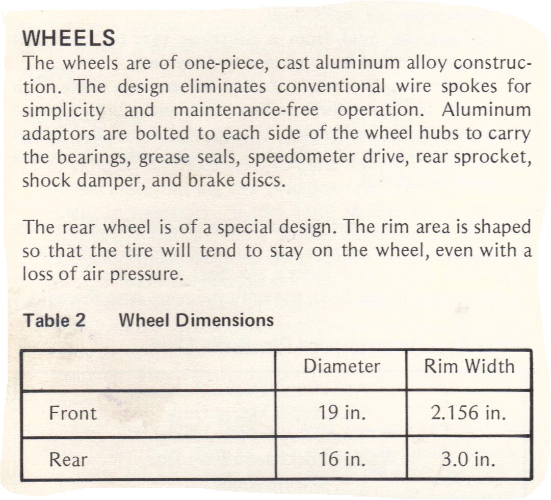

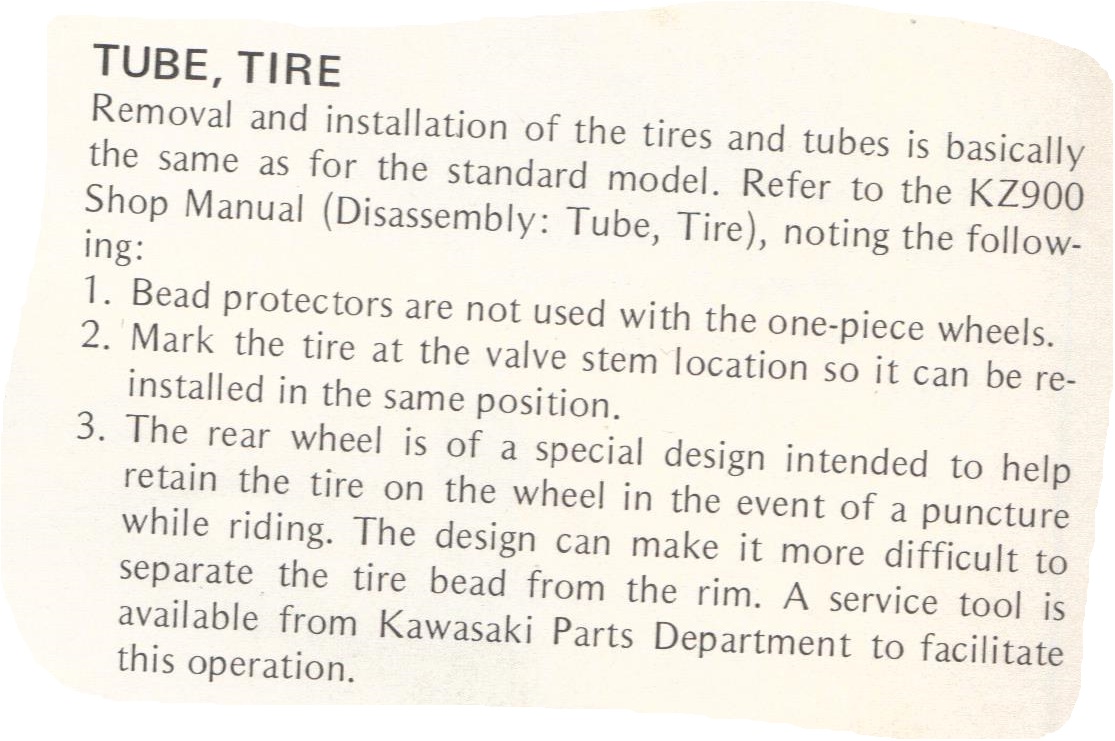

In any event, here are excerpts from the FSM supplement pertaining to the KZ900-B1 LTD's genuine Morris Mag wheels that were fitted at the factory:
Have never risked running tires without tubes on the mentioned Morris Mags.
And would not elect to bore a hole in them to adapt a tubeless valve stem.

07 Jun 2014 07:33 - 07 Jun 2014 07:35Interesting that Kawasaki also used the same rim profile with the raised ridge on the spoke wheel that requires a tube.
