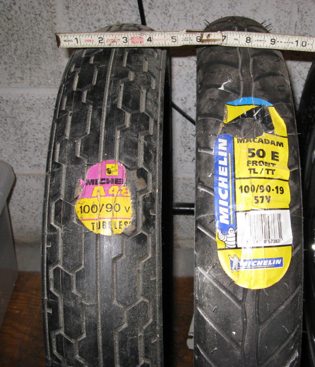

The 120 tire wears very uniformly and lasts as long or longer than the narrower tire. I've been using that size for quite a few years and find that it works very well. It's width is so close to that of the original tire that the profile isn't distorted.
One other thing to consider is that despite what tire charts show, different model tires labeled with the same size can have very different widths. This is even true when they are from the same manufacturer. It shouldn't be the case, but it is, and sometimes the widths vary by a whole lot. Below is an example of what I mean. Both tires are manufactured by Michelin. Both tires are size 100/90-19. And yet, one tire is at least 1/2" wider than the other. The tires are shown unmounted, but I can assure you that the difference was still just as obvious when they were mounted on the rims. This may also explain why some tires are easier to mount than others. The inner diameters may also vary somewhat between tire models. The lesson I learned from that is that the tire sizes are approximate at best and it pays to physically compare tires when buying. Ed

Re: tires and tubes
27 May 2014 12:24The diameters are different as well you can see that in the picture. Funny how much variation in tires that are supposedly the same size.650ed wrote: One other thing to consider is that despite what tire charts show, different model tires labeled with the same size can have very different widths. This is even true when they are from the same manufacturer.

27 May 2014 12:35
Yup. I'm glad they're making tires and not handgun or rifle ammunition! :woohoo: Ed
