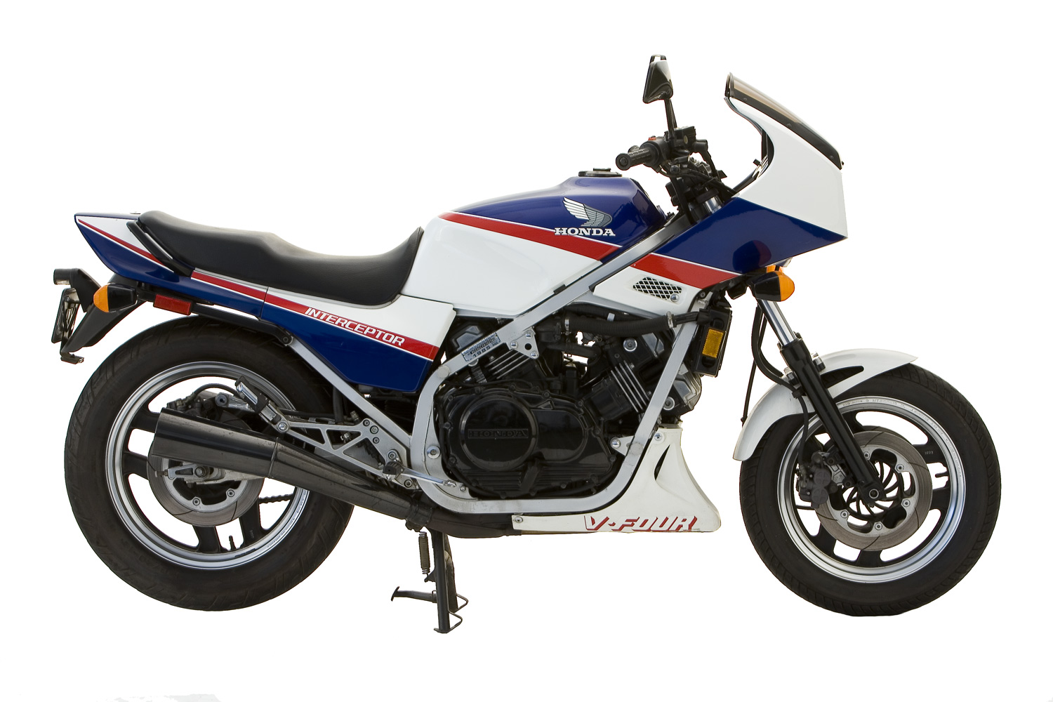

A Honda Nighthawk
or Honda Interceptor
BOTH have 16" wheels. Try it. What's the worst that could happen? :blink:
