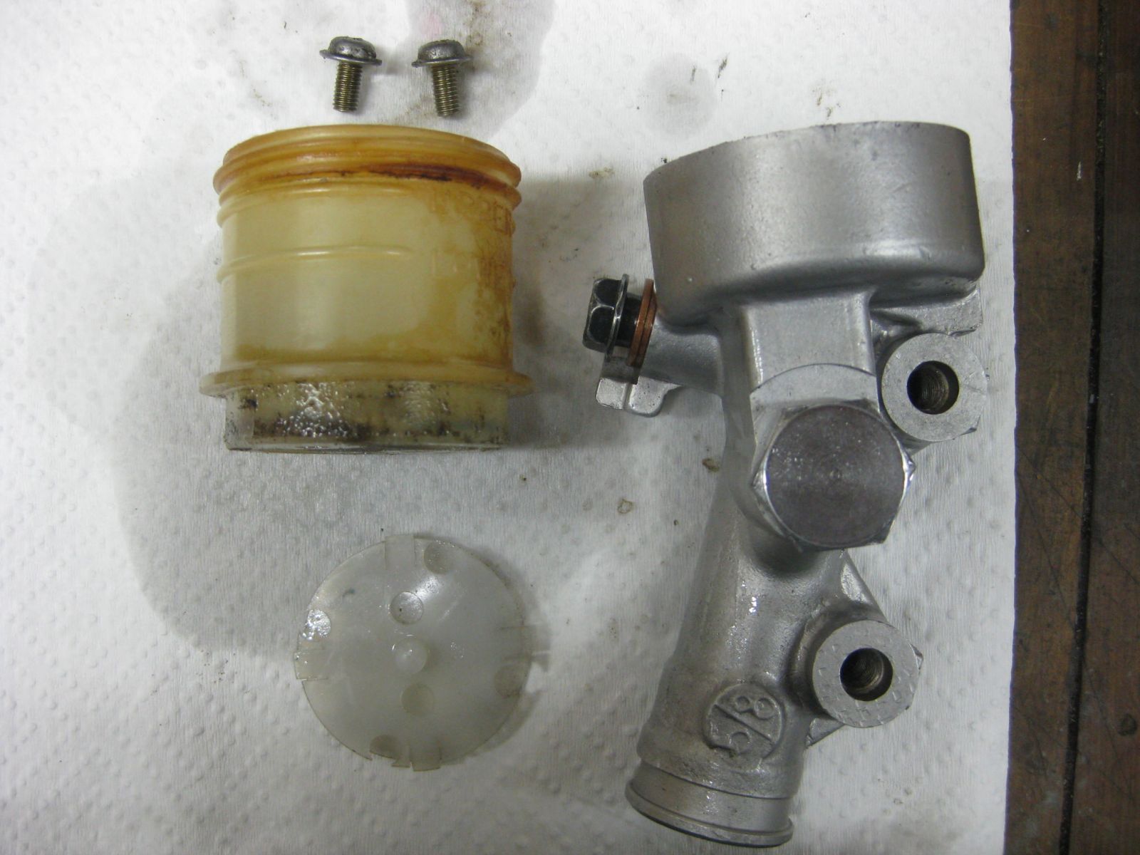

22 May 2014 01:41 - 22 May 2014 01:43Some good news! I was able to separate the reservoir from the m/cyl body, I carefully lifted a plastic baffle plate and revealed a couple of screws securing these 2 parts. There is a seal between the reservoir and the body which requires replacement - thus the leak! Just have to source a new seal - believe that Redline Cycles may be able to help, will keep you posted. A couple of pics to help anyone else who has a Z1-R with leaking m/cyl around the junction of the reservoir and the body of the m/cyl. There's a lot of crud under the reservoir so I'll clean that out before re-assembly.

Re: Z1-R Rear Master Cylinder - Weeping
22 May 2014 01:47
Another pic to show the internals of the m/cyl.

- Thanks: 2833
22 May 2014 05:00
Glad to see it came apart ok! The pictures you posted should be really helpful to anyone else with this same or a similar reservoir. Ed
