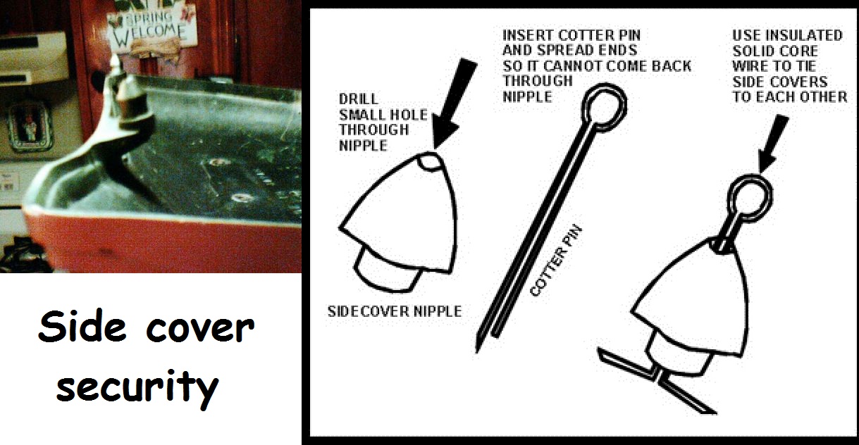

Another option
Good Fortune! :)

Patton wrote:
Another option
Good Fortune! :)
...As opposed to changing the grommets every few years?
...Great ideas, yet hardly worth the time and effort when you can pop in a few new grommets. Also, for the sake of retaining the OEM originality, I'll just do the swap. :)

KraZyRIDER wrote: ... Great ideas, yet hardly worth the time and effort when you can pop in a few new grommets. Also, for the sake of retaining the OEM originality, I'll just do the swap. :)
As president of the fresh grommet fan club, I heartily endorse them.
Unfortunately, many folks just don't think about needing to replace the grommets until they belatedly discover having lost a side cover.
Side covers have been lost with new grommets, and side covers have been lost from relatively brand new bikes (would guess mostly from improper installation where all the nibs were mistakenly not pushed fully and firmly into their respective as-new grommets.)
Besides requiring a more careful and deliberate installation, the diy security feature also offers some very limited protection against quick-snatch theft of the side covers.
And of course, concours examples most likely won't have holes drilled through the side cover nibs.
