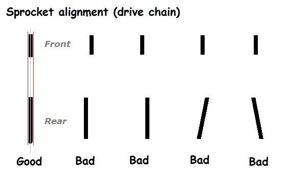

Are sprockets aligned?
Is chain kinked?
Is chain properly lubed?
With chain removed, does the problem persist?
