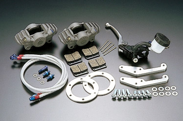

I've been wondering the same thing. By the time you rebuild everything correctly, you can have a lot of cash invested in the old calipers. It seems there should be a fairly easy upgrade but I haven't had any luck finding one. You'd think there'd be an adapter out there that bolts right up with a specific, newer model caliper...haven't found one yet. They have nice kits in Japan but they are really expensive....around $850 without rotors or master cylinder. They sure look cool though!
japan.webike.net/products/1523198.html

13 Oct 2014 23:11 - 13 Oct 2014 23:1179MKII wrote:CSP wrote: So there's no possibility for reasonably priced upgrades without swapping wheels or the whole front end? I'm probably looking around $100 for rebuild kits, and another $40-50 for a master cylinder... I'm pretty much limited to that for under ~$200?
thats not too bad of a deal considering those lockheed calipers are about $300 each.
