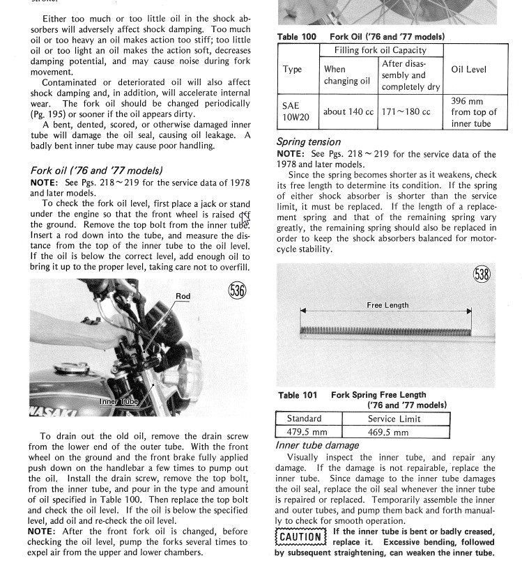

#627973
buffalowinger wrote: I'm trying to figure out how many cc's of fork oil to put in my kz750 front end. I just disassembled them, and cleaned everything and changed the fork seals, now I can't for the life of me find out how much fork oil to put in them. Any help would be greatly appreciated.
I copied the pages from my 1979 750 twin factory manual. Probably similar for yours, no guarantees. You do put the front end up on a jack to clear the front wheel then check oil level with a dipstick method.
1979 KZ-750 Twin

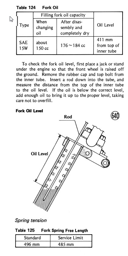

Re: 1980 kz750 twin fork oil capacity
05 Apr 2014 13:39
#627974
Second page showing level check:
1979 KZ-750 Twin

650ed wrote:
80B4 wrote:
80B4 wrote: 140mm from the top of the tube, springs out, forks fully compressed, 10 weight (15 if you are over 220lbs). If there is too much brake dive add 10mm of fluid and try it again. Fresh springs?
650ed wrote: Fully compressed??? I don't think so. Don't you mean fully extended? I've never seen specs where you fully compress the forks. Ed
80B4 wrote: Yes, fully compressed. 140mm from the top of the tube, spring out, fully compressed. Every fork tuner I use ( race-tech, traxxion and others) specs that way. Do some research, you will see.
You're simply wrong - see examples below. Show me a Kawasaki manual that does NOT say measure with the front wheel off the ground. - I'll wait for it. Do your own research and get back to me. But don't give me that old "I know a guy who knew a guy who had an uncle who went to races and a guy there told him he once talked to a tuner who knew a guy......" Show me the printed words from the manufacturer that gives the specifications for the 1980 KZ750 twin. :laugh: :laugh: :laugh: Ed
