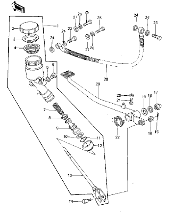

Anyone know when I can just get that part? I took mine apart to clean inside and its all buggered up and is leaking now. I just want the o-ring that seals the reservoir.

z19OO wrote: Anyone know when I can just get that part? I took mine apart to clean inside and its all buggered up and is leaking now. I just want the o-ring that seals the reservoir.
Large Kaw fours had drum rear brakes until rear disc was introduced on 1976 KZ900-B1 LTD. Thereafter, rear disc brakes were used on all large Kaw four models.
A rubber DIAPHRAGM part no. 43028-003 is the flexible rubber cup that fits onto the master cylinder reservoir before the cap is screwed on. The diaphragm cushions the fluid squirting back up into the reservoir from the piston bore during brake application, and reduces the splashing around, and seals the cap area against leaking.
May google the part number to produce several retail sources for the diaphragm.
Am thinking that the same diaphragm is used on most if not all stock large Kaw four master cylinders.
Could check at kawasaki.com to compare usage of the same part among various models, and will need to know whether the master cylinder at hand is indeed a Kawasaki component (as opposed to an after-market item or a master cylinder adapted from another brand of motorcycle.).
If needed, here's a link for help with navigating the kawasaki.com web-site and finding information such as parts diagrams, part names, part numbers, models sharing same part, availability, etc.
www.kzrider.com/forum/13-bike-related/37...imitstart=0&start=20
Good Fortune! :)

Yup, that's the one I need. I should have stated its for a 1978 kz1000 with stock rear master cyl.
I looked on the Kawasaki site and they only show the whole MC, no p/n for the o-ring. I guess Redline it is. Thank you!

z19OO wrote: ... its for a 1978 kz1000 with stock rear master cyl.
kawasaki.com doesn't show the large o'ring listed at Redline.
www.redlinecycle.com/Brk%20-%20Trap%20Rsrvr%20O-%20Ring.html
Per kawasaki.com :
