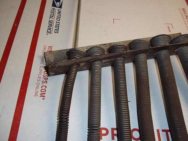

You need an old fashioned tubing bender. Mine here is 50 years old.
The tube is 1/8 car brake line which works with the bikes. Flex spring lets you bend the tubing.
But if you make your own, YOU HAVE TO DOUBLE FLARE the tube ends.
