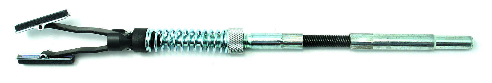

No eBay APP ID and/or Cert ID defined in Kunena configurationHave used very fine wet/dry sand paper to "dress" the bore surface, which smooths over any peaks, but doesn't affect minor pitting depressions, and the rubber cups worked just fine with no fluid leakage.
Brake cylinder two-stone hone is believed available that would be small enough to run inside a 14mm m/c bore.
