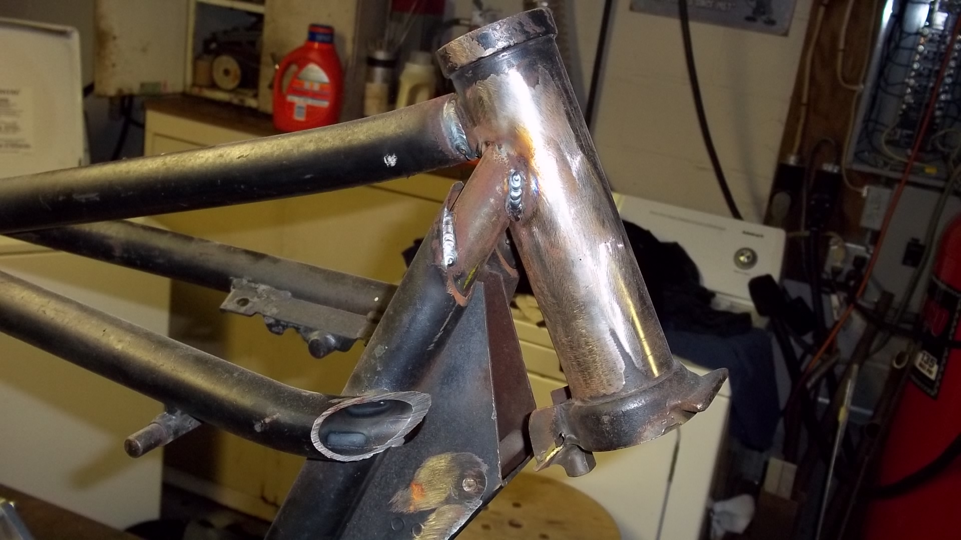

Thanks guys for all the feedback- seems like a bad idea. especially when it would be easy to have the frame chopped up and neck adjusted by a pro. Or just get a raked frame to start the project...
