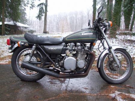

When I got this bike it had these little shocks on it and big chunks of the tire missing from hitting the rear fender.
