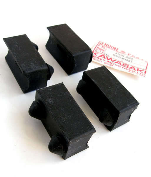

Thanx for the feedback, all! I got spend an unseasonably warm Ohio afternoon riding instead of wrenching but took some time after to think about an adapter, now that the concesus is in, and I know I'm going need one. I am approaching this very carefully...I do not like the thought of baby landing on either the floor or myself! No wobbles, please! I doodled up something that might work...I. hope the pic is sufficiently legible...dimensions yet to be taken, just for my visualization aid...no art critics! LOL! really like the seat bumper idea, but the exhaust would have to come off first. Not a big deal, I guess, but if this channel/hook confabulation would be strong enough, one could work them between the frame and exhaust tubes....still kinda like the idea of building a table lift out of this little thing...seems like it might be a lot more stable..thanx again, all!
