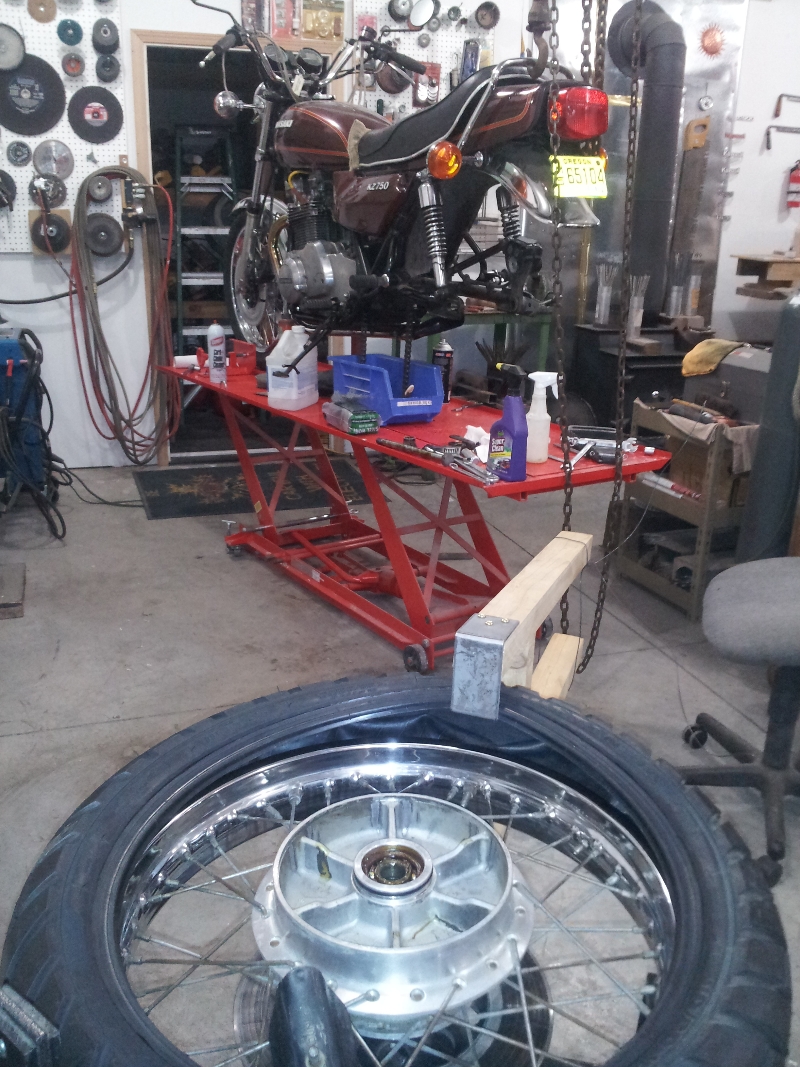

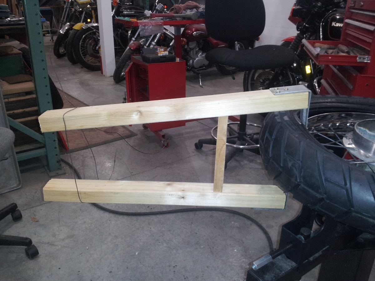

Ed, you suggested having a friend spread the tire but I couldn't figure out how to pull the lower bead down while pulling the upper bead up so I built my own bead spreader. I used some 1/8" by 2" steel strap and a couple of sawn down 2X4's.
In order to reach the lower bead I had to make the lower hook 1" longer than the top hook. I filed and ground all the edges to remove any sharp burrs.
Can you say AHH?
Once pulled open the assembly was easy.
Can you say AHH?

That bead spreader is REALLY cool! It looks like it does make the job easier; so I may copy it next time I replace my rear tire. Great idea! Ed

Good idea on the speader. Maybe the tires you are using are a stiffer sidewall than most, but all the years I've changed tires simply laying the tire/wheel on a soft pad on the floor, use the left hand to lever open the tire, right hand to install the rim lock has always been a simple minute or so. Of course every tire different in how they are made, some easier than others.

Personally don't use the rim locks anymore but back in the day I used to. No matter how you did it, putting those things in was a pain...and sometimes I mean literally. It got to be such a hassle I just stopped using them. Never had a problem but some guys do like to have them in there. That spreader looks like the answer to the problem though.

thats using your head..good pictures...awesome twin 750 just super cool....rim locks..they make a cool sound when they hit the metal shop waste can......little black plastic finish screw covers close the holes nice from the outside...

That spreader tool is way cool.
